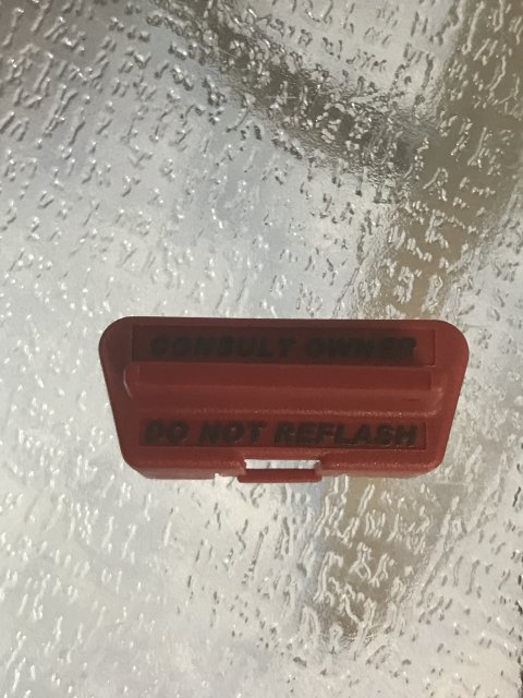

Never ever let them flash your tuned PCM. I even fire a warning shot.
