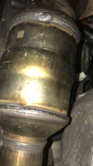

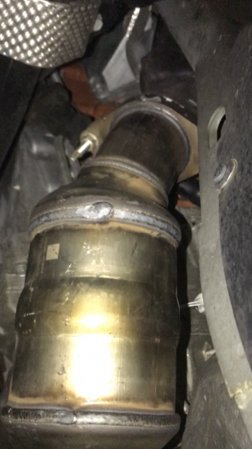

Took mine in today and it seems like my dealership didn’t replace them. Wtf.

That seems bizarre, I'd contact Dodge and open a case !

I’m not sure if new catalytic converters look that way out the box. My hellcat is only at 16k miles so most bolts and parts still look fairly new. I will give them a call tomorrow and verify.

I'm no CSI, but if you look at the details - the scratches, the welds - like the scratch running diagonally through that square highlight, it is clear these are the same cats in both pictures.
That was my thought/observations as well - what are the odds of both the old & new cats having that exact same scratch !
4,112
10,324
None you got got. My cats were shiny as hell and had a sticker on them with your part number. Someone sold your cats probably. Look for a sale in your area.
Yes, it is two photos of the same cat.
