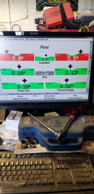

You are dead right on the contact patch, have a full set of BMR on car adjustable arms to take care of just that and these Demon alignment specs which should put the tire dead flat on launch, that’s the hope at least. I’ve read most all hellcats contact patch looks like this and will make tires that see just hard launch and 1/4 pulls often, and that what these tires say.
Yea, they are all folded up because I put them back on one last time for line lock testing, that finished them
off!! These specs are minus driver, with 200lb driver they match side to side. When squated this should make them flat and square to the road.

Oh yeah. Get that done ASAP. It will change the entire way the car feels under WOT. You will literally feel the ass of the car planted under acceleration solid. Then you just control the nose and keep it pointed straight.

WOW, that good aye?? You just gave me the motivation to get cracking on getting them installed!! THANKS!!
So these alignment targets look good by you??

those wheels shown in the pic above, those tires are out of balance. One side has tread and the other doesn’t. Those tires are trashed.
Too much negative camber wears the inside of the tires first
No, this is coming from off the line wear due to uneven weight distribution on the tires due to how they orient when under acceleration. The guy thread I screen shotted these specs from I believe knew what he was talking about. Another high HP whipple or KB guy, the guys on this forum I think as well. I’d have to search back through threads if posted to find him but if might have been Mark??

Yea, that’s probably the guy
