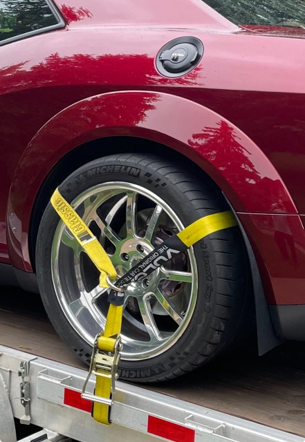

If anyone would like to keep this going, I still have a lot to figure out. I've been towing
boats, horses, dirt, uhauls forever but never a vehicle, and this is one I really care about. I will be doing a few 15mi trips to the dragway and 2 long trips/year 350mi to land speed trials. Northern ME is low/no traffic, summer driving, 75 speed limit, soft rolling hills.
Someone recommended etrack, looks good and reasonably priced. I think this makes it easier to strap the front and avoid air dam damage. Not sure it is really necessary in the rear.
Is it ever better to cross strap L-R?
I have slingshot wheels, not sure if I need wheel nets or straps through the wheels with protective fuzzies.
I think I have the race ramp figured out, looks like I will make my own to dimensions tailored to the car and trailer.
A lot of you have been towing cars forever. Sharing experience is always greatly appreciated!
No. Aside from that straps don't like being rubbed against each other, you're giving up a fair amount of strength by having the straps at that much of an angle.
To me the most important part is to keep the trailered vehicle from moving forward. That's because nobody always have control over how quickly things come to a stop. So I tend to make the rear tie-down setup the strongest.
Also, I prefer tie down, as opposed to tied fore and aft. That rules out tying to suspended parts, which is something I never do to anything with suspension no matter what.
By tying down there's far more friction between the trailer deck and tires, so any lateral or lengthwise movement is pretty much eliminated. Wheel nets, or straps over the tires, takes care of that nicely. Lasso straps is a close second if the anchor points on the trailer won't accommodate nets or straps over the tires.
But hey, it's your car, your trailer, your choice. After having trailered literally millions of dollars of cars for tens of thousands of miles, I know what I prefer.

Which is why I appreciate your help. I'm going to tow maybe 2 times to Land Speed, 4 max. A few short trips to the dragway. Then the trailer and everything else will be sold.
I prefer to avoid a huge investment for low use. I was thinking maybe 4 straps on the back, 2 straight and 2 cross, retaining the rear is 90% of the game (I think). The front is just to make sure it doesn't roll off the back or fall to the side in an emergency/collision. I have no prob adding custom mounting points if necessary.
Thanks for your help! :)

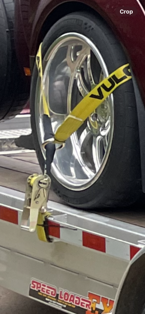

I completely agree with that the rear tie-downs can be the most important, but four...
The two that would be crossed is a no-no in the first place, and if at about 45 degrees their strength/efficiency is cut in half even if the abrasion between them hasn't lowered their WLL. And that's not even considering the physical clearance for them. Would work better if it was your pickup on the trailer.
Two straps at a slight angle outward from the wheels will provide nearly full strength in a frontal collision scenario, yet keep the Challenger in place laterally.

Agree. Except that I'd use the far more substantial stake pockets instead of the rub rail.
8,719
53,398
#74
Why? The car is positioned for the center of its mass to be where I want it. Jimmy for the experience you have, I am surprised you are telling me to position the car with respect to some minor shit on the trailer as opposed to getting it in the correct load point on that trailer. Show me structural calculations where tying it where it is positioned is not adequate on that rail. Show your work and I will be interested in vertical vectors please.
8,719
53,398
#75
You may also want to research the distance btw our axles and the position of those “stake pockets”. Before you get to carried away, sir.
6,780
12,618
#76
In your case, if the car is positioned correctly for tongue weight, I'd run the lasso strap to a stake pocket D-ring in the stake pocket just behind the center of the tire.
I have never run four lasso straps straight down vertically, wanting more fore and aft efficiency. And why the stake pocket D-rings? Because I only use hooks with clips, not wanting anything to possibly be able to detach.

When towing my cars with expensive suspension, we always have rings on the body, and keep my shocks from beating themselves to death. Hundreds of miles of towing = 4X the dragstrip passes on the suspension. Just how we do it with our racecars. Opinions and applications vary....

Thanks. I did a bunch or research and this was a popular setup, but my immediate reaction is the pulling down and to the side does almost nothing for F-R support. In hard braking I would expect the car to shift forward until the strap is at sufficient angle to provide rearward support. I was thinking maybe using this system and adding another strap from the D ring to the trailer rear tie down point.
