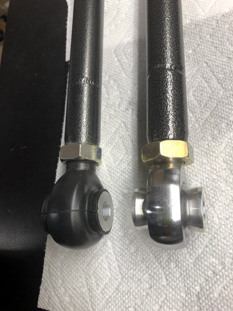

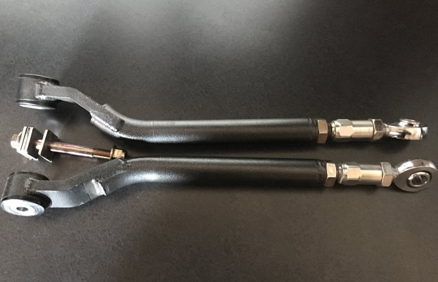

I called BMR on the width issue with the trailing arms, needs a washer on each side then was a perfect fit. I put rubber boots over my rod ends as well but will be removing these links and putting the on car adjustable ones on as they look beefier. 6404417D-FC14-484E-89AB-26DE971EF85D.jpeg 5D9F9EA0-0D5F-44A2-86ED-4A0D0387E9AD.jpeg

I called BMR on the width issue with the trailing arms, needs a washer on each side then was a perfect fit. I put rubber boots over my rod ends as well but will be removing these links and putting the on car adjustable ones on as they look beefier. View attachment 16561 View attachment 16562

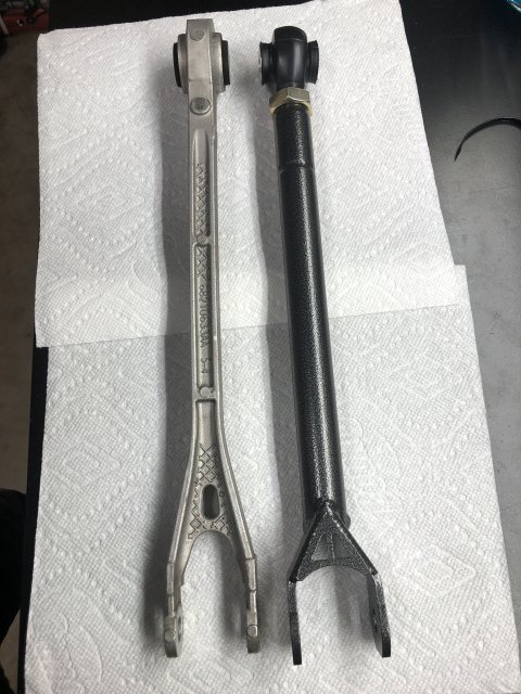

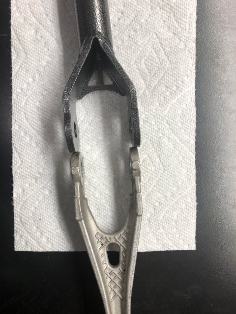

A picture is worth a thousand words! Look at that weakass cast aluminum trailing arm. They break! Even had one break on the dyno. Not everybody wants to go to a full drag suspension but if you are modding at all..... that along with the DIRS brace, is one of the things that needs to be done.
Yea, the difference from stock to even the BMR arms is night and day, couldn’t imagine how beefy the AAD stuff must be in hand

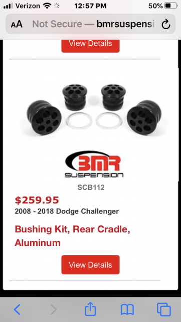

You mind posting the part number of the cradle kit you used? I mine as well do it as well while I’m under there

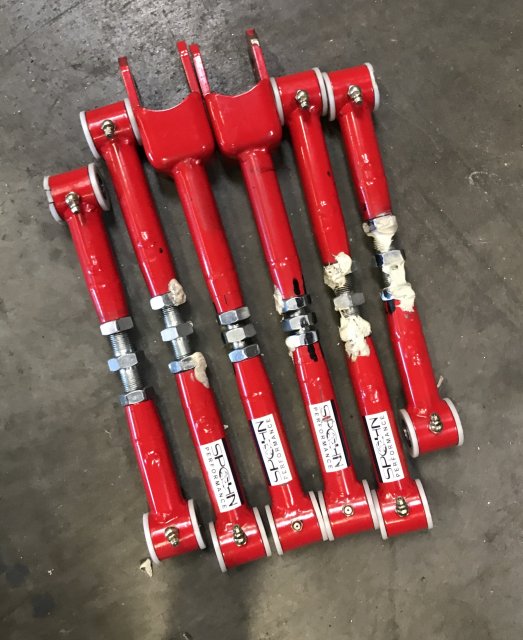

. These are the Spohn adjustables I just pulled out. Chromoly and very stout. No bending those. You can see my “goop” application that keeps the lock nuts in place. Professional all the way 😝. Those are sold to Primetime. I also had a BMR toe link on there and those are going to be for sale. They are the skinny end joint version from Carlyle for a 15” wheel conversion. E91BE137-AA7C-4646-861C-D67828A76E9B.jpeg 2D5C6E8A-C61D-41F3-9E7A-07ADF3B11B6E.jpeg

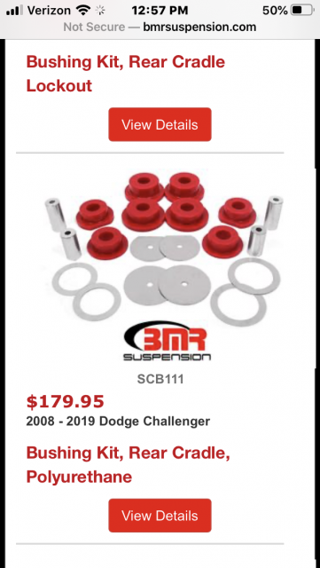

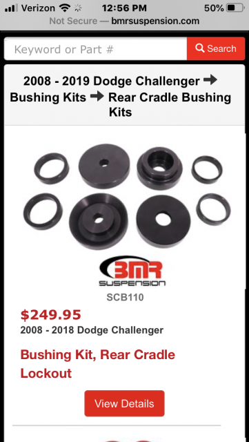

One of these? 7137E3F4-968A-4A8C-B072-9F5777D9B932.png C883B939-F9A0-40E8-A89F-4C6249CF2E20.png 96B7C766-8F36-4B04-8E71-26698DEC8F3E.png

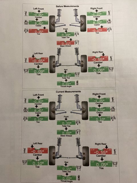

This alignment took adjustable four corners by AAD, plus the BMR rear toe adjustable items. It ran a 3.3 second 0-60 and 11 sec flat on the street with street tires. It don't flipping hop anymore either. It feels out of this world to drive now, big difference from stock.
Interesting. I just put indy 500 305/35/20s on 11" MMR rims my 1320 for daily driving and my rear alignment is nearly identical from FCA to what you put yours at, though the shop told me they couldnt adjust anything in the rear camber without adjustable parts etc etc. Maybe its good they couldnt.

. These are the Spohn adjustables I just pulled out. Chromoly and very stout. No bending those. You can see my “goop” application that keeps the lock nuts in place. Professional all the way 😝. Those are sold to Primetime. I also had a BMR toe link on there and those are going to be for sale. They are the skinny end joint version from Carlyle for a 15” wheel conversion. View attachment 16587 View attachment 16588
Nice looking parts......should make a nice difference.

Scb112 is BMR part number For the cradle kit/ lockout kit.
Not that much different. Notice the spec mine has says the rear camber is good up to -0.2 degrees, not -1.2 degrees. Otherwise both of ours are red. The more positive is better for the street/acceleration. I see the guys who race go more positive.

@Hpindy
What cradle lock out kit did you use? Any idea on part number?
I got this one
