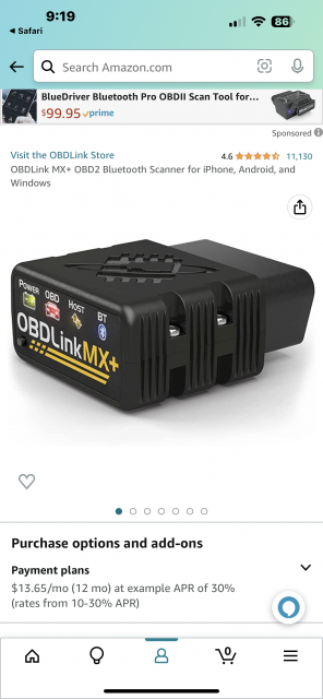

ELM327 interface
Plus 5 for software?
8,670
7,638
ELM327 interface
$50 for softwar (off their website) and get an obdxii
8,670
7,638
Er, obdmx+

thanks
