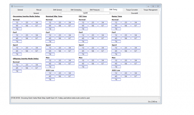

These are the tables he is referring to. None of my changes to these tables are very much but you can feel a difference from minor changes. When we are talking about every 10th possible everything helps.
Hey hey, I borrowed that trailer to just go to VMP, but am actively looking for a rollback or easy loader. In regards to the time to remove from the fill values, -50, -75 and -100 are way to agressive in the perf/sport/max tables. I was thinking -25ms to start off with in those tables. Thoughts @jonx96 ?

@Speedy! the books use -50/-75/-100 ms increments for mild/moderate/aggressive respectively. Issue is for some tables you dont want to go below 50ms or 20ms in certain tables based on the guidance. Even with mild changes you’d have to bring those values right back up to the minimum.

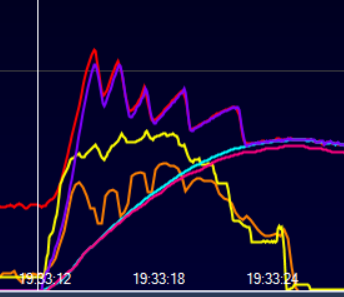

Same here, after that post I went even lower, I only went for -10 and not in all spots. Just to smooth some things over. @Jack_Toepfer this Friday I'll be testing WOT but I had an incomplete trans tune at VMP, I was afraid to touch the "fill" tables at all as well as touch some of the TCC lockup and especially the torque management tables. So all I did was up line pressure and raise shift points. This will get you somewhat far but as you command more and more pressure and want higher RPM shifts you HAVE to change those tables. They all work in unison. For me I moderately removed how much spark would be removed from the shifts, changed some fill times and even just those the car feels completely different. Here is a graph from a log 4/17 before the changes.
3-4 shift was flaring, torque management was also being a pita, see those sloppy U peaks, keep in mind this was just me going to approximately 30mph, nice and soft around town. Here is a log of me today with all the changes in unison.

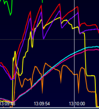

Torque managemnet was in and out, peaks are nice and razor sharp, still going ot approxmiately ~30mph cruising around town.

What's the yellow line in the graph?

Yellow is expected torque, orange is actual torque.
