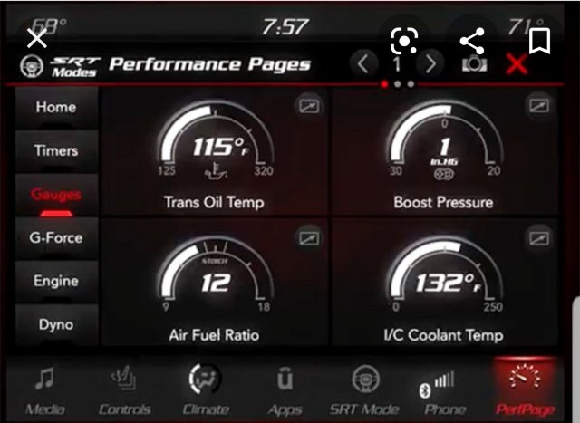

Have any of you guys been able to pull up trans temps on your HP90's?
I have tried in my '16 Challenger and get nothing but instructions on what to do when the trans overheats.

Thank you.
Engine must be running to pull trans temps up on screen.
