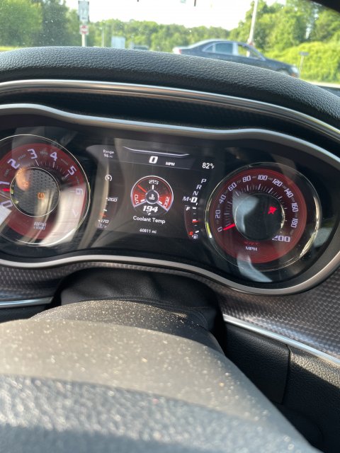

Thermostat potentially may be stuck closed…

Also getting them up to temp helps keep the cats intact. So high temps are good for the motor, but bad for performance because it’ll run better when it’s cooler than hotter (in some cases) … pick one.
My concern isn’t the 203* it’s the fact that the colder thermostat should be maintaining a cooler than stock temperature.
