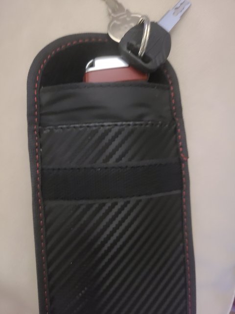

Faraday is supposed to contain the signal from getting transmitted, if I understand it correctly.
7,256
18,920
Seems as soon as you take it out to unlock the car the would be thief could just snag the signal right then if that's what's happening?
D
Thread Starter #171
Oh no. You have to point it out the end of the bag and close it back up.

I've never heard of just peaking the FOB out of the faraday pouch when opening or starting the car.
I was given this crap for my birthday. We use the faraday box but I'm not carrying around a pouch.
I don't know you're supposed to peek the fob out of it. I'm just being retarded tonight.

I guess my point is, as soon as you let the signal out of the bag a thief can capture it. You have to let the signal out to open the car. So not sure how that helps. Having the fobs away from the car, or in a signal blocking box, when at home probably has some merit as it would prevent someone running an amplifier up to your window or something and getting a signal to the vehicle. I'd think that only useful if you park outside though and not in a locked garage.
I'd still like to know how common signal cloning is. I think that takes much more specialized or home made equipment vs the stuff they're doing to copy a fob from the STAR port in the car.
