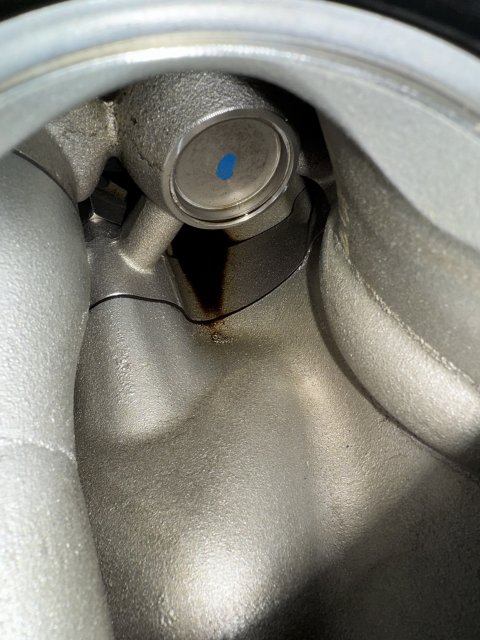

So I bought this 2015 hellcat challenger about 2 months ago. It was all stock except for a Legmaker intake. My plans for it are 100% drag car and no street driving. It was wrecked when I picked it up and it's pretty much ready to go now. I have only driven it about 2-3 miles. I wanted to go ahead and replace the intake gaskets with cometic gaskets since stock are usually something that fails frequently.
Here's where I may have bigger issues?

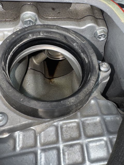

So I pulled the blower lid just to check around, and when I did I noticed almost all the blower and lid bolts were loose. Like rattling around loose. As far as the rotors, they looked good to me(pics below) but I did notice a good amount of oil at the bearing plate(1-2 tablespoons I'd say). Also I did notice when I installed the catch can, there seemed to be excessive oil in driver and passenger pvc hoses. So I'm pretty sure that's where it's coming from but if someone thinks different please let me know. I guess worse case it'll get a full rebuild with a goal to make 1200ish HP.
My main question for you guys is this amount of oil/blow by normal for a car with no catch can?
Plans for the car as of now- it is gutted sitting at 3900lbs with some more weight to be removed. 2.78 griptec, ATI 10% lower, ID 1300 injectors and E85. Eventually ported blower, headers and who knows what else. I'm sure like most projects it'll go throw plenty of changes.

The intake track looks very clean. That oil probably came off or out of the rotors from sitting an extended period of time possibly. The one rotor has hollow lobes to it that can collect oil. Check the cooling bricks to see how oil fouled they are, they may need cleaned. loose lid bolts I’ve heard of before.

Not an expert but that looks like excessive oil unless it's from the lobes

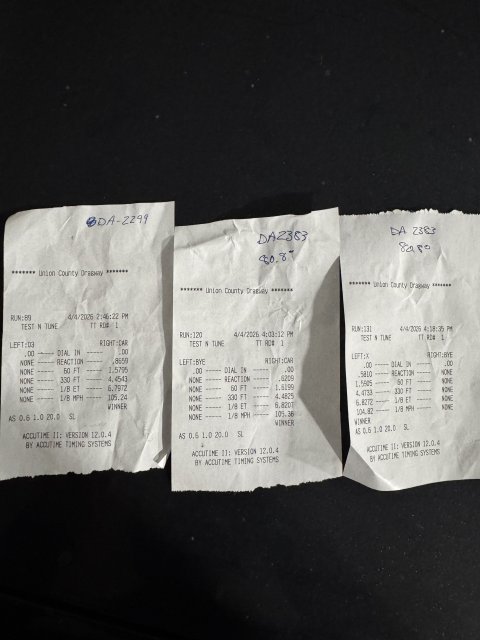

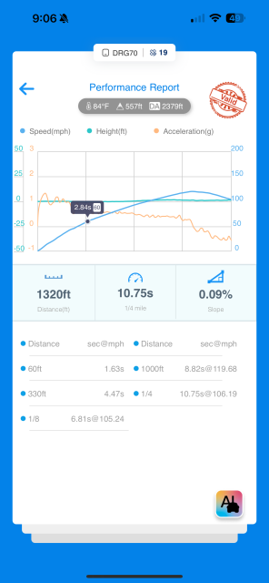

Finally had a chance to get the ScrapCat to the track for some baseline times. Temperature wasn't ideal at 80° and 2300-2400' DA but better than nothing. 2015 Challenger Hellcat still at stock power, making 9-10psi and went 6.79@105 in the 1/8. I got on the brakes just after the 1000' and rolled to a 10.75@106 in the 1/4. The goal by summer is to be 9s in the 1/4. Three passes 6.79,6.82,6.82 definitely more consistent than expected. All with slow 60', leaving off of idle.
Things I currently have and will be installing very soon- ID1300, 2.65 griptec upper, ATI 10% lower, Kooks long tubes, MagnaFuel 750 pump, 5 gallon cell, ignite red and will be tuned by Barth. If it makes at least one solid pass that will definitely be in 9s. And highly thinking about 100-150 shot.

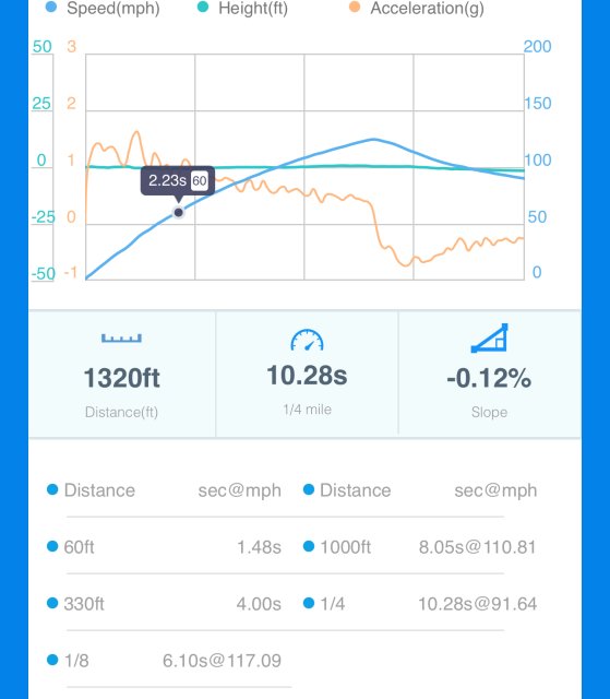

Well dropped some more weight, added 2.78 Griptec upper, ATI 10% lower,1300cc injectors, and Ignite red E90. I'm still stock axles and a stock Redeye driveshaft so I didn't launch first pass just to make sure I got some data before anything broke and went a 6.36@115 with a 1.68 60'. Next pass launched and slight wheel hop(right wheel spun 180° inside the tire). The timers were off for lightning so all I had was the dragy. It had been reading .11 slow on ET and .1-.5MPH fast on two other passes so could have possibly broke into 5's?? Dragy showed 6.10@117 with 1.48 60'. Either way it was better than I expected.

Got any paperwork showing your 1/4 mile time?

It's 1/8 mile track but here's data from the dragy. Obviously got on the brakes right after the 1/8 as you can tell on graph

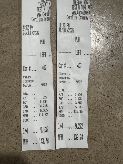

This past weekend I got to make two 1/4 passes but unfortunately neither were full passes. The second pass was good but just got on the brakes too early before the traps, the shutdown got a little sketchy the pass before. After the first pass, radiator somehow shifted back into the idler pulley and put a hole in the coolant hose so had to go to parts store and repair that. After that it was so late I didn't have time for another run.
Anyways, same mods as before with a 8.50 cert cage now added. Stock, unopened engine, stock blower, 2.78 griptec pulley, 10% ATI lower, ID1300, LMI intake, Ignite Red E90 fuel, and diff brace. 100% stock suspension, Not even a cradle lockout.
1st pass- 9.63@143
2nd pass- 9.27@139
I wanted a 5 second 1/8, and got it with 5.93 and a low 1.3X 60' and that happened as well, 1.33 60'. It blows my mind that this car sat in a junk yard for 4 years and only engine maintenance I done was changed oil and plugs lol.
