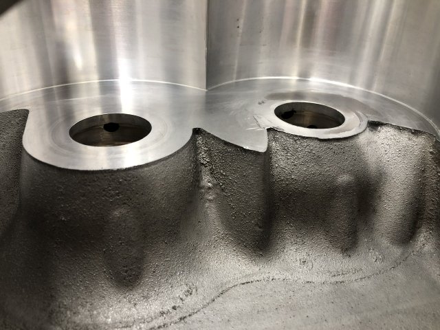

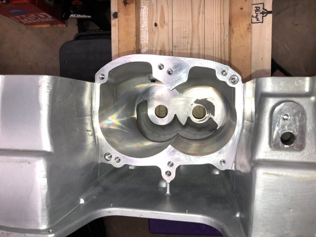

With a total of .008 to deal with what sort of front/rear split are you planning to go with? Also, is the number .008 a factory supplied spec you're stating or an as measured number from a blower you've measured?
Clearance I’m referring to is between lobes male/female mating clearance on the lead and the lag sides of the flights, measured with long, 12”, brass feeler gauges wormed up around them. When I say .008” per side it’s because when I tore my second blower down to install the FAS plate that ruined my first blower I measured, marked, and documented EVERYTHING as it came apart. My second blower had .006” on the .lead side and .010” on the lag side, .016” total. I don’t know what this blower had to start with but it was msking 17.25 psi of boost with a 2.85 and this blowers making 16-16.5 and I can only think it’s from lobe relationship as there’s not much else that’s Changable in building it. Big debate inside is I don’t know where exactly it’s supposed to be, split in the middle, tighter on pressure side??? I talked to Jon Bknd twice, he’ll of a nice guy but not sharing ANY tips, tidbits, or even directly asked question even as simple as timing of the blower, his own words, he’s in business to rebuild blowers not give secrets away so everyone can do it, understandable but geez lol. Anxious to sell me parts though lol.
