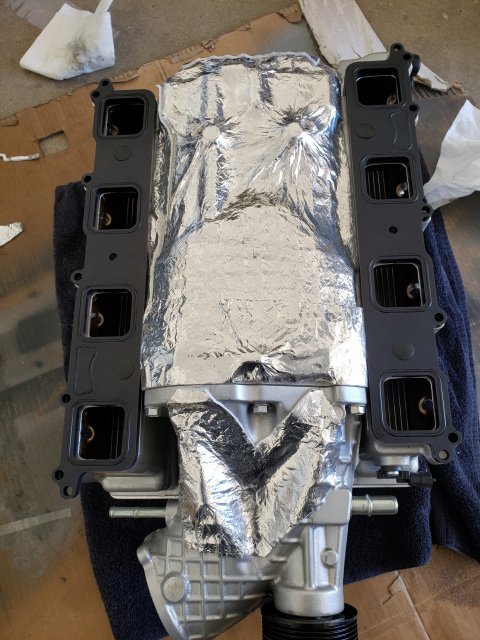

But on to a serious conversation.....when I got home from work I started taking the supercharger off .Started with having a couple bud lights...then I took the wipers arm's off time for break had a another couple bud's..then took off the push pins that hold on the windshield cowl.. time for a break well you know you get thirsty working so hard. Then took off the cowl and brace. Break time...then took off the super charger cooler hose's and if I had the guy that engineered those hose clamp location I would give him a good country boy a$$ whooping break time after that for sure.4 hours later I was typing this my wife of 48 yrs. came in and ask me why was taking the super charger off the wrong Challenger!!! I told her I may have had to many bud's helping me.

No really I did take the super charger off the hellcat when I got home....after taking everything loose and I cut me 2 piece's of 2x4 about 2' long raised the charger up and kept sliding them till they took and half way.Taking another 2x4 5' long broke the charger loose till it came off the dowel pin reached before charger and pulled close enough I could get a hold of it and just pick it up and put it on a plastic tote that was close.....Will you guy's let me where those dang puch pins that came in the kit go....I believe I seen it on a video where they attach the spacer's to the charger? And they stay on there? The charger will mate back to block with them on there? Ok 3 question

I had it out in a couple hours....any wanting to do this is easy peasy. Going back I'm gonna get my son or one of my grandson to help where it can be placed down easy.I'm also going to use some bar stock from ace to make longer dowel they had 5/16th which is 7.90mm and they stock one are 8mm

Yep those push pins hold it to the supercharger and they will not be in the way for bolting it down. I did the blanket that way so I can take the snout off
Thanks yep thats what I thought I seen....it seems strange that it'll mate back but it got dark on me and I really didnt noticed the heads.Sure appreciate the pics. that'll help
