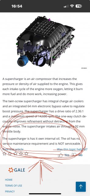

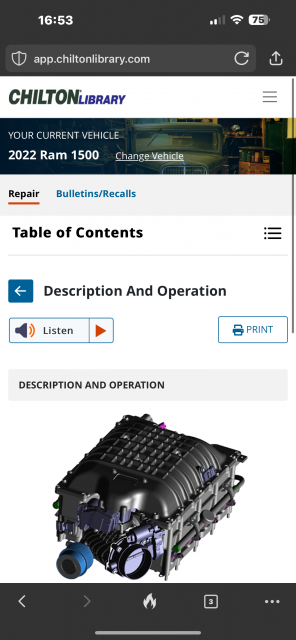

I also have it on good authority (TK himself !) that you should rotate the SC rotors at least annually. The finish tends to get 'chaffed' on the inlet side which can eventually cause them to be come unbalanced with catastrophic failure soon after.
3,933
9,717

No oil lasts forever, however the oil in the IHI SC (Mobil Jet Oil II) should last a very long time.

Ask them for documentation that indicates that there has been a change to the S/C maintenance saying that the oil is no longer lifetime and now has the (ridiculous) service interval of 15k miles....
