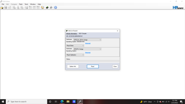

I re-pulled the tune tonight. Something still seems off. Take a look under General, tell me if something seems off. At least I'm seeing engine information in this read - and the size is closer to what I've seen on other posts.

What seems weird under general? You have a few additional tables but I'm guessing it is because you are a 2021. Seems fine to me from the quick glance I just did

Red key says 500hp and black key and HO say 797hp. Doesn't affect with the red key in the car, though. Strange.

My guess hp tuners has it mixed up for those few tables. I'd send support@hptuners.com an email. Below is a standard response from them that if you provide up front it'll save some time. My guess though it is fine just if you ever want to change the screen you may have to modify the wrong box to get it to present how you want.
Or you could ask your tuner. Hopefully he has seen a couple 2021s with the same OS to compare.
1) VCM Suite Infolog while connected to the vehicle as shown here http://www.hptuners.com/forum/showt...hy-is-it-so-Important-when-contacting-support
2) Debug file from your PC. You will find this file in ...Documents/ HP Tuners/ Settings
3) stock read file
