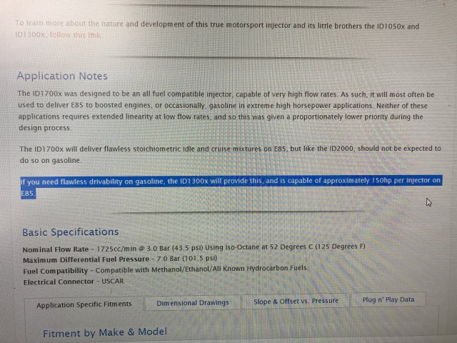

Not with these injectors

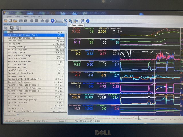

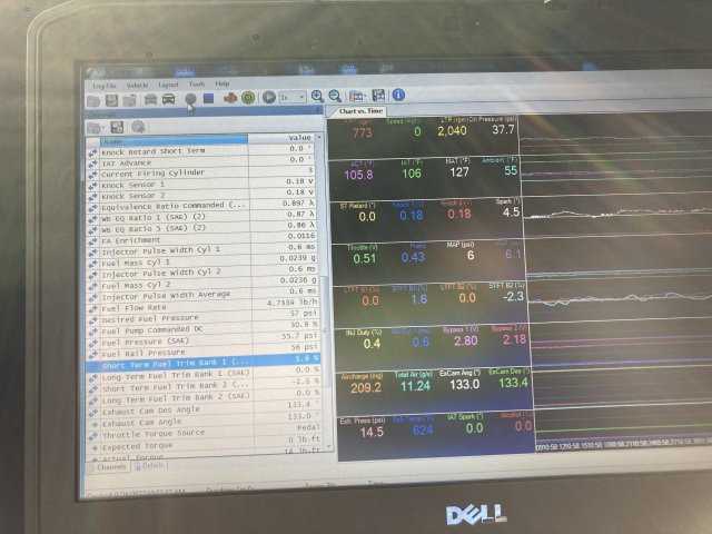

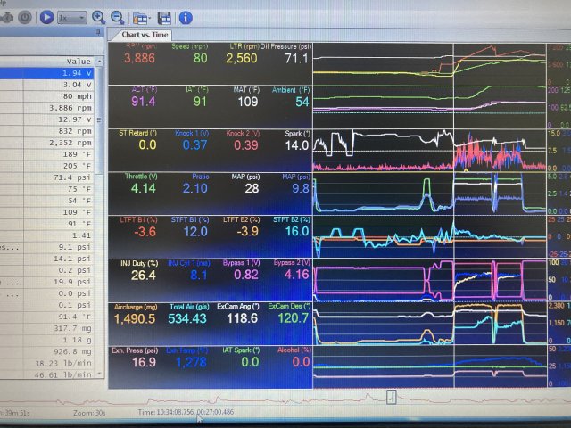

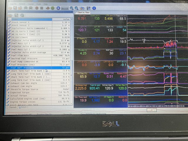

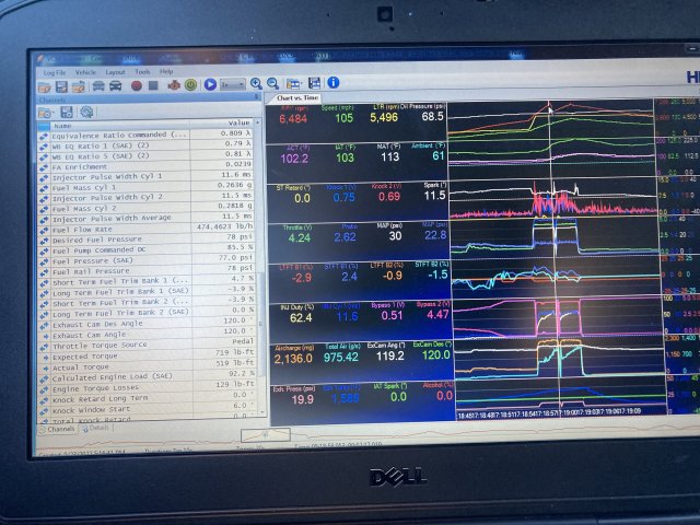

I did some dialing in of the injectors last night, in less than an hour had idle at 0% LTFT and cruise within 3-4 and WOT (one short hit) was +6, then my laptop battery died which sent me home :( I think we’ll have them dialed in before the weekend is out. I have a work related party to go to tonight so no playtime this evening to finish them up. Most I saw injector DC wise was 45% and 12 milliseconds at 5500 rpm, pump DC never topped 79% with a new set point of 78psi at WOT, 56 all other times. Looking good so far. 👍

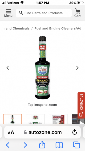

The Lucas E85 Fuel Stabilizer is the trick. I know guys have there been using it for 10 years plus, they never run anything through their vehicles except E85 pump flex and out of the barrel and when it comes time to store their cars for winter they fill them up as much as possible to expel all air (moisture carrier) and just let them sit with the stabilizer in it and the entire fuel system double strength, 2 ounces per 5 gallon. I’ve done that for two years myself so far with no troubles.
https://www.autozone.com/fuel-and-e...oducts-ethanol-fuel-treatment-16oz/977411_0_0

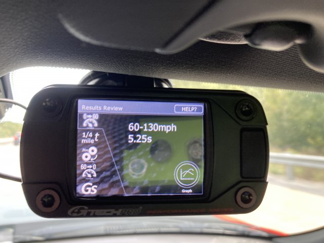

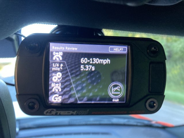

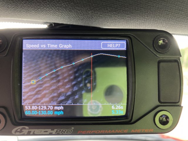

3rd gear pull trims looked good for a 60-130 run do I let her have it. Not bad for 1 hour of street tweaking and a 12 degree max timing safe timing timing table thanks to @jonx96 This engines not a timing hog lol. Back to 19 degrees soon! Draggy battery dead so only Gtech data. Same bridge as usual, no slope, If anything it’s .45° uphill in the direction I ran.

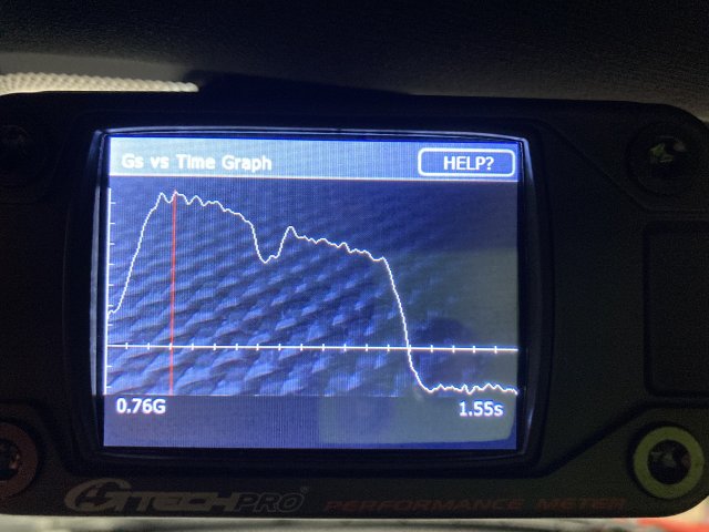

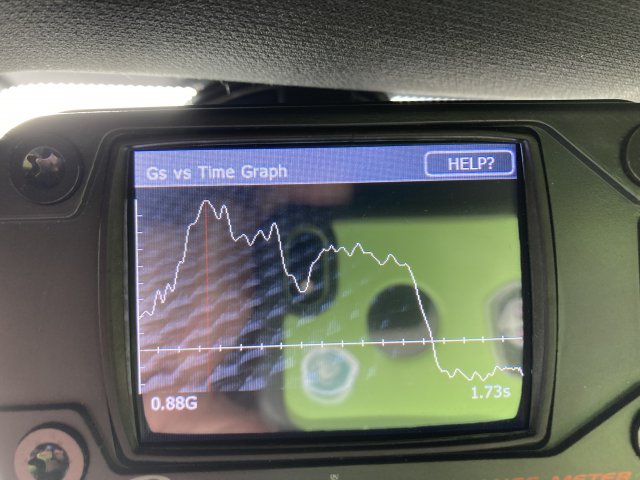

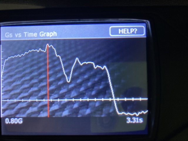

GForce graph of that 5.37 run, shows the declining G Force of the reduced timing up top during the 3rd and 4th gear pulls
8B4FA4BE-3A2B-446A-BA80-B26F2F4B5745.jpeg 93F710D1-53B0-44C1-8FB5-695A3E051CE0.jpeg
Verse a 19 degree up top run
5F5B9675-7CED-4DFA-8280-1DCE62F12ADA.jpeg 792E0173-A3C8-480E-8F85-929E029ED512.jpeg
Less wheel spin from less timing probably netted the better time.

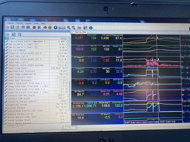

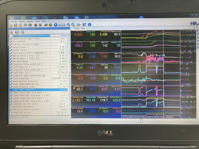

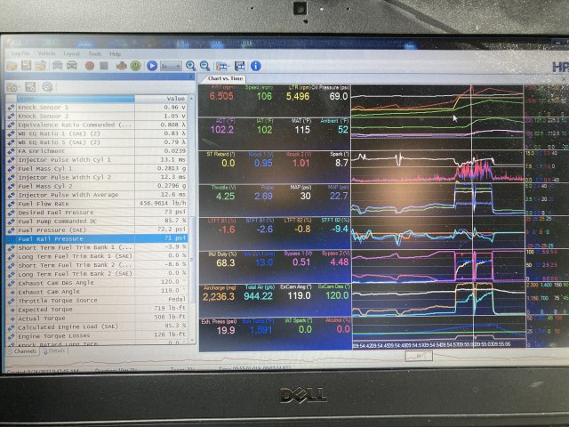

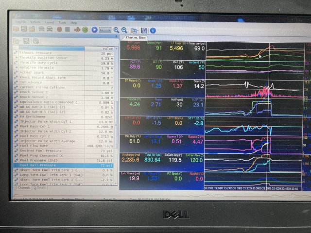

Injectors pretty dialed in now, Still a bit of fine-tuning to do to get them as close to zero as possible but they’re runnable as is. @jonx96 desired fuel curve working well, pump system kept up even on a “extended” run.
