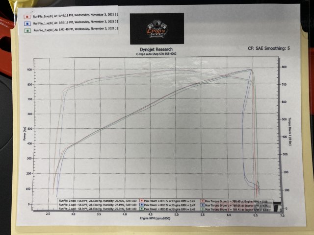

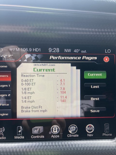

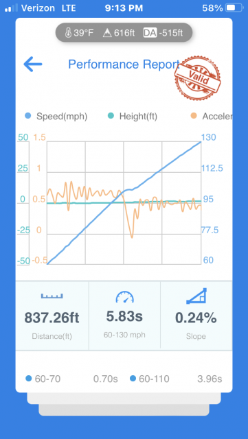

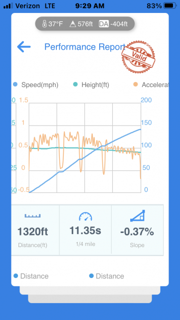

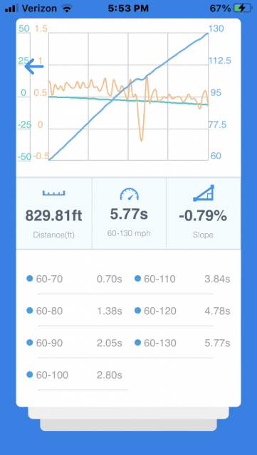

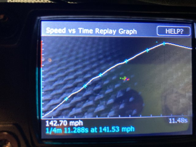

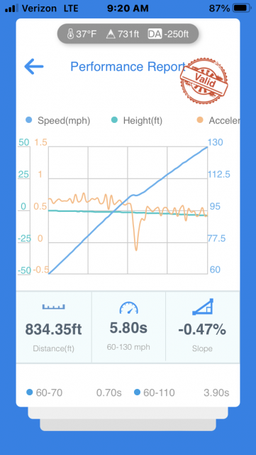

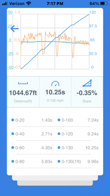

Yea, LOTS since the last posts!! I didn’t think anyone would be interested in hearing the continued adventures of 16GoManGo lol. I’ll post up some of what’s been going on to get to below, maybe it will entice some interest in the pains to get here with a M6 cat. All street data, haven’t been to the track with her yet.

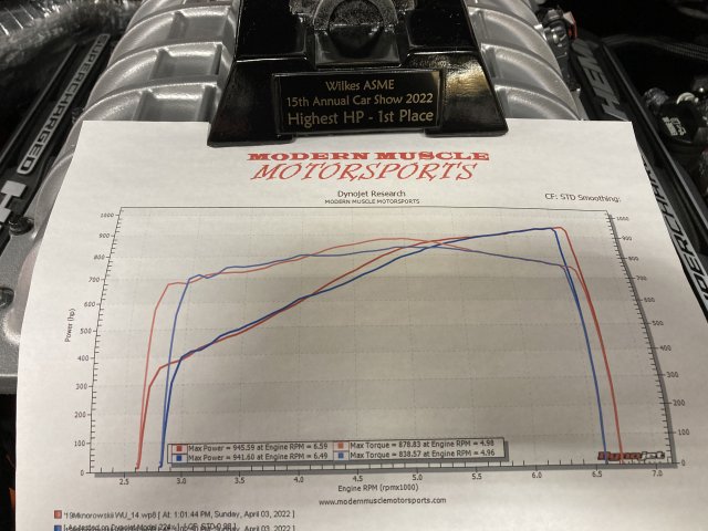

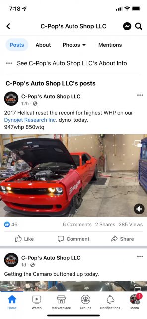

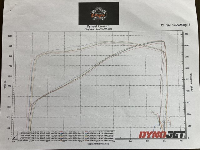

MIke, are you showing new results? Sheet shows like 900HP but FB post says 947?

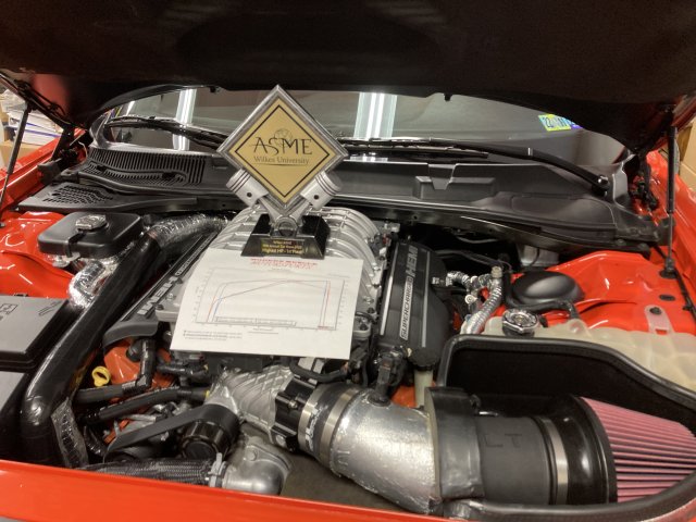

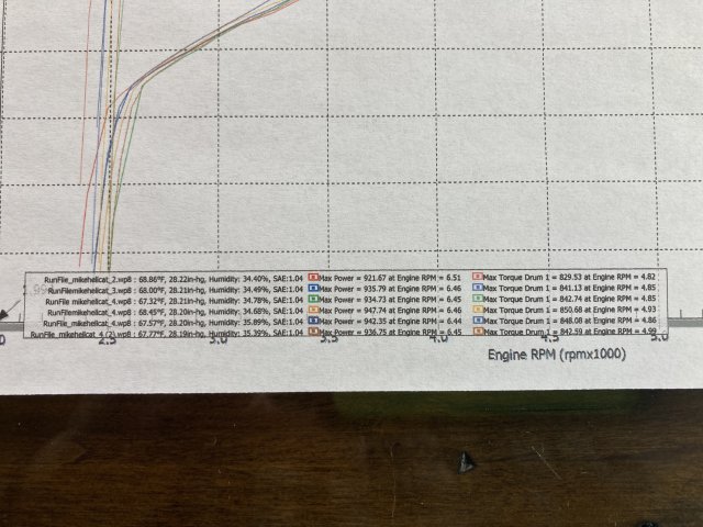

I attached the wrong dyno graph. That’s before @jonx96 aka @Jon-MooredPerformanceLLC did some tuning magic on a pulley upgrade, here’s the proper dyno sheet of that tuning night, settled on the tune that netted 947 and change. That weekend won 1st place in the dyno HP contest at a local colleges ASME department car show.
A71EE893-A87A-4417-B99F-55F38B89268B.jpeg 2F33D1E3-86F3-4F01-87CE-E7C7B527A058.jpeg 12D88FF8-1C3F-4E93-B90E-2242F964F92C.jpeg 759B5A42-994E-4A4F-88F0-C709A82FC533.jpeg
Both dyno’s match pretty well. Notice how fast she spools that dyno lol, 50-145 in 3-4 seconds. People there were like “WTF was that??” Reply was that’s how quick 850 wheel tq spins up a dyno!!

Out of all the cars I saw from that event yours was about the only one not showing knock at that event
A good tune does that 😉
That’s why that video was taken from that angle, precisely what I was watching for, GOOD JOB my man!! 👍👍
I ran my car last, broke allot of hearts lol , kept hearing during the event as I was parked by the dyno, ah “It’s just a Hellcat”
Yep, was just a Hellcat :)

@jonx96 so you were obviously dialing a couple things in. Do you have a feel for how much RWHP each degree of timing is worth? I've heard 10 and I've heard 15 and I'm curious. I've always split the difference at 12.
That’s a tough one to answer. I could go back and look to see what was added each pull. But these cars get to a point where 2 degrees doesn’t make much of a different. Off memory this was a max of 19 degrees of timing and 6500 rpm.
As far as times go at the track or street the ramp in of the timing is more important than trying to get every last degree. Same max timing but playing with ramp in of timing (stick car) worried about traction we were knocking time off like crazy.
