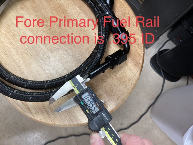

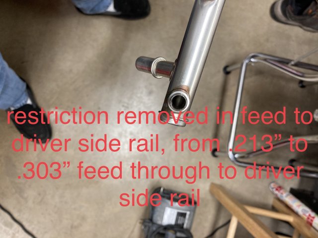

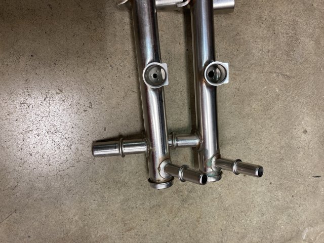

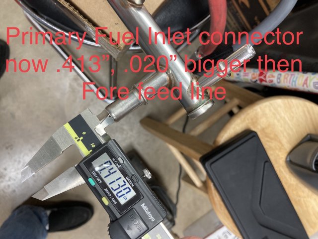

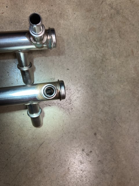

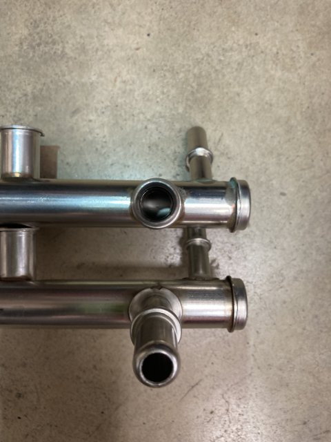

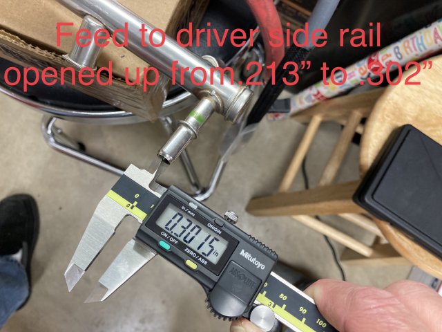

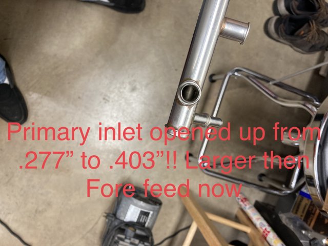

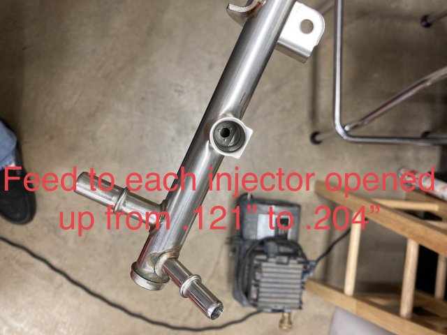

Started the cat up today in prep for hopefully tomorrow a WOT 1-2-3-4 data pull. Did a start up log, log shows idle fuel trims -2% more negative at idle both banks. Here’s some side by side stock to open’d up comparison photos. 773643A0-3359-4AB1-8685-9D11A4D1C5D5.jpeg FCBD7981-9FFE-491A-AFF7-5C13414428DB.jpeg 6E69A54E-7233-43C4-B684-685370C7C86A.jpeg E8D454CB-0E0A-4CA6-80C4-0CE3EC484779.jpeg FB8EE359-BF36-4210-AE26-AB00BD729042.jpeg 350AC05D-C37E-4370-B989-B6E869A3353E.jpeg CC9D0625-9C9E-4CDD-A8C7-D7A13EDB5E0A.jpeg 760F724B-9C35-4D3A-BE3A-D497CD0461EF.jpeg

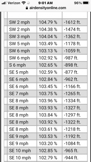

The DA is going to be there today for apples to apples comparison to a -1000 DA log taken 11/29.
This is projected DA hour by hour from 9am forward today, so even mid afternoon will work.

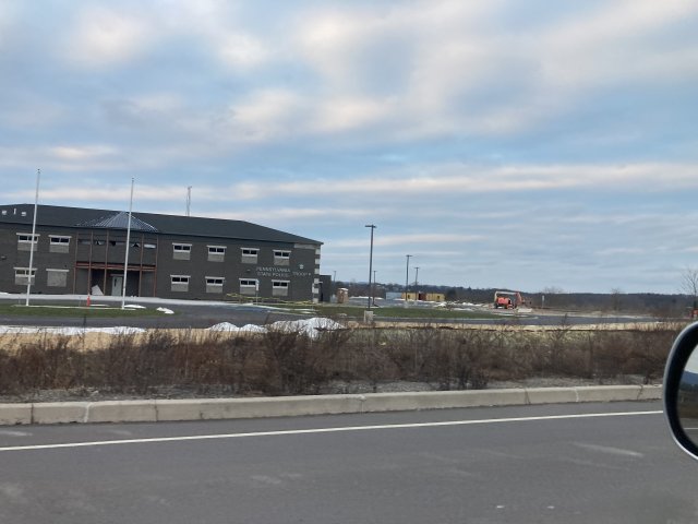

Any one zoom in on the picture of the new building being built in my playground I posted? It’s been going up for 3-4 months now, I’ve been wondering what this super complex was going to be, huge garage complex on it, air handling and purification system to rival a hospital, I drive by it daily going to work and watched the build, well they put the letters on the building last week, :( parties over for this playground LOL

Ok, here it is, 2 log videos attached, one of today with the modded rails and one to compare too taken late November with same exact ambient temperature and almost the same DA as today. Unfortunately nothing miraculous from the mod but it did enlighten me to 650$ of a Fore Fuel Rail upgrade would have been a waste of money as there is no doubt in my mind these modified rails will flow as well as Fore ones that are fed in the usual configuration they are offered in using a stock fuel pressure sending unit. After studying these logs I see WOT fuel trims are more equal bank to bank. The fuel demand peak is around 420 lb per hour which is about 68 GPH. According to graphs on TI site a 285 pump should deliver 100 GPH at 80 psi, so dual ones should deliver 200 GPH. So either I’m calculating this incorrectly or there’s a big restriction somewhere between the pump outlets and the fuel pressure sensor. Before I upgrade to triple pumps or 295’s I’m going to be looking for that restriction first.

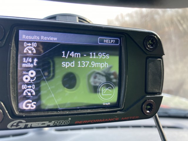

But managed a decent 1/4 run, the 315 555R2’s didn’t due to bad on 30F pavement. This is the 1/4 Run in the log video. HEMI therapy was much needed and I enjoyed it and miraculously my car stayed clean :)

Great data! Here's a couple observations.
I'd remove a degree or two of timing at the upper RPM areas and 1.80g (1800mg) and up aircharge. That knock appears real to me and you definitely don't want that.
Fuel system is definitely maxed out in current config on full E80+ fuel. Your inj pw is getting up there at 17ms and I did see the bypass start to open to bleed some boost. Mixing down to E70 will still give you probably 95-98% of your timing map, and take pressure off the fuel system if you wanna save some bucks on upgraded injectors.
Interesting that your changes did seem to balance out the trims bank1 to bank2. I've noticed on my car that bank1 seems to always have a bit more trim than bank2, usually 2% or so. The fact that the fuel feed comes in to bank2 and crosses over to bank1 likely explains this.
It's been a long time since I studied fluid dynamics, but I seem to remember a single restriction in a given system meant the entire system was restricted to the same degree. Keep in mind there is a venturi and valve in the passenger side saddle that limits fuel pressure to 90(ish) psi on standard Hellcat, and that fuel flows from passenger saddle to driver as part of the pump process. This is one of the reasons it's a bit difficult to siphon the tank as well. If the pumps aren't running this venturi doesn't function so you end up siphoning only the driver saddle unless you key cycle the car a bunch of times, or leave it running, or jumper the pump relay.
On the RE this passenger side venturi/valve setup goes on up to like 110psi if memory serves. However, with more pressure you will start to lose some volume. Finding that balance is where the money is. More isn't necessarily "more" more if you know what I mean.
I've been seeing the highest aircharge I've ever seen lately in my testing at 2000+ mg. I'm seeing around E75 calc'd E and my inj DC is tickling 85% at 6500 RPM. Desired fuel pressure is 94 and actual is 89, so not awful but could likely use some bigger injectors to line it all out. I'll rarely be in 2000+ aircharge type air at WOT, that would be a holy grail day for me at the track, so I'll have to weigh what worth an upgrade, keep my eyes open for some second hand ID1300s or something, and decide then what's what. I definitely couldn't run Ignite E90 in this weather though.

I will definitely try taking a degree or so of timing out in the top end and see what she does, THANKS for the suggestions. BTW, 2% bank to bank difference is about what I used to see as well, like bank 1 had less pressure and didn’t have to trim as much fuel out for the same injector pulse width across the banks. That morning I added 10 gallons of tested E85 from jugs, car calculated down from 85 % to 83.5, close. It’s been hanging right at 85% the last 2 fills on this same fuel, winder why it recalculated it lower different this time? I’m probably just going to run it as is this next season, I’ll look for more fuel restrictions while adding the Fore undercar E85 filter set up from TAPPED. @Speedy! Did you install yours yet? A forum buddy of mine did his which was a HHP kit and said is was a real PITA??
