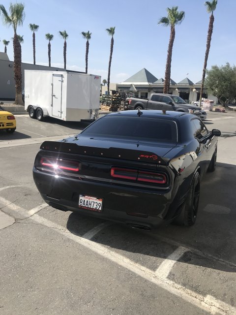

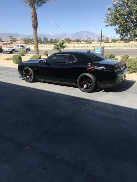

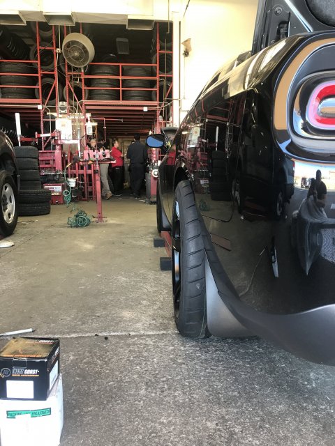

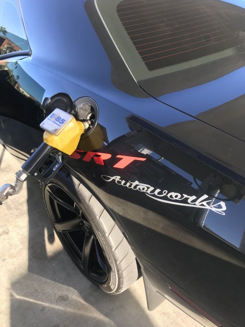

I’m running a 315 tire in the rear on a 11 inch replica with no issues on my Challenger! It looks badass with that staggered look.315/35/20 traction is awesome. View attachment 8917 View attachment 8918 View attachment 8919 View attachment 8920 View attachment 8921 View attachment 8922 View attachment 8923 View attachment 8924
Great pics, thanks for sharing. What brand of wheel is that, and do you happen to know the offset.
Primetime Hellcat 17

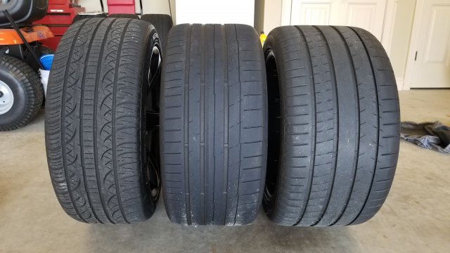

And a comparison of a stock 275/40, a 305/35, and a 335/30.

My only concern with the 305 is that the rolling diameter is a full percent off from the 275, so while the 305 seems like the obvious choice that is the reason I am seeking more answers as I am by no means am expert on this topic.
The 305 difference is not an issue. the sensor at the rear/driveshaft compensates so no speedo issue and seemingly no ABS issues either. the height diff is there but is barely noticeable.

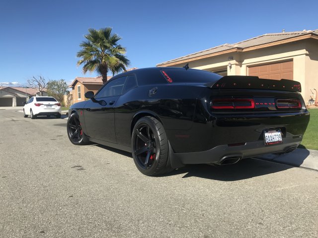

D5DA4C57-09DB-4155-B3B7-32C7E3BFCA8B.jpeg 3ADD4CC6-491B-49E5-9795-829F1766B3D6.jpeg A8976EB5-7E24-4C38-813D-AA6C61856DD4.jpeg 2B5E941F-1653-41D1-A351-A824BD0934C9.jpeg 5666361E-0EF4-4042-88B4-752C8CC34333.jpeg
Here is a few more pics with the 315’s on a 11 inch wheel.
