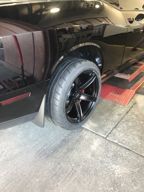

The 315 will either poke or rub or both. Been there done that and other sizes. The recommendation of 275 front 305 rear is spot on for the regular body Challenger. The Charger has more room in the rear.

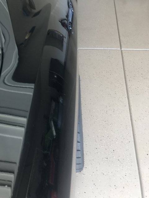

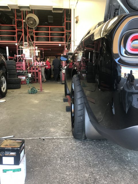

Pics of mine with the 11" rims and 305s on the rear
Here is a top down view

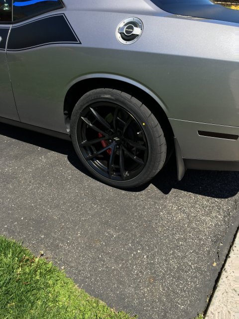

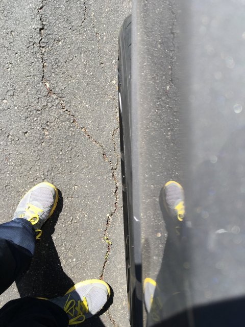

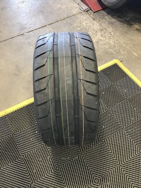

I’m running a 315 tire in the rear on a 11 inch replica with no issues on my Challenger! It looks badass with that staggered look.315/35/20 traction is awesome. DBB0B01B-F0D7-4FA4-9FD7-67B4628D95CB.jpeg AE332D36-EB15-4F3C-8B50-883E693B18B1.jpeg 4C273015-8278-42AD-AC5B-514F51CC0AC1.jpeg 737AEDCA-341A-44BA-B98F-825F150D1043.jpeg 9FF7B141-AADA-4340-963F-1028E3787596.jpeg 76FBAB5C-2501-4458-B5BF-76BB2C8AE9BE.jpeg A297359F-D50A-46D5-861C-C01B7D1A01E5.jpeg 5BEBE4A3-FC04-4D4F-81A8-095BEE819257.jpeg
2,696
I’m running a 315 tire in the rear on a 11 inch replica with no issues on my Challenger! It looks badass with that staggered look.315/35/20 traction is awesome. View attachment 8917 View attachment 8918 View attachment 8919 View attachment 8920 View attachment 8921 View attachment 8922 View attachment 8923 View attachment 8924

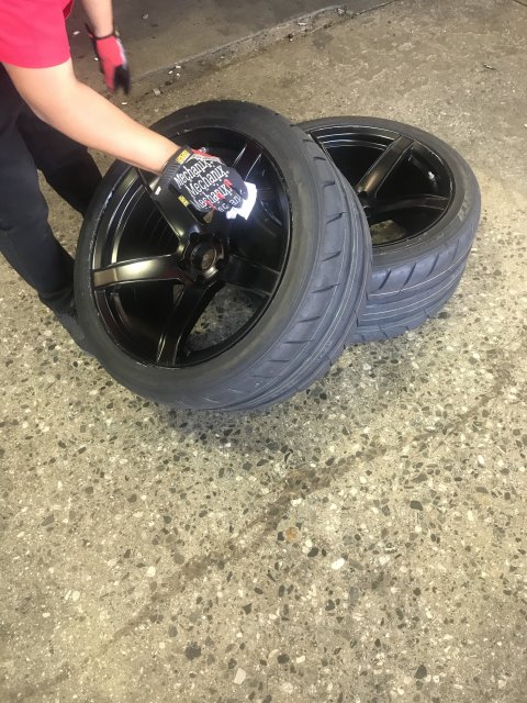

Who's rims you using and what offset? Those are exact replicas of my RE rims and would match perfect. Also those tires are Nitto's correct? @Blkout, as I have read elsewhere, said they run a little narrow so maybe that's why the success. BTW don't want to steal the thread but how's the King Kong cam doin'?

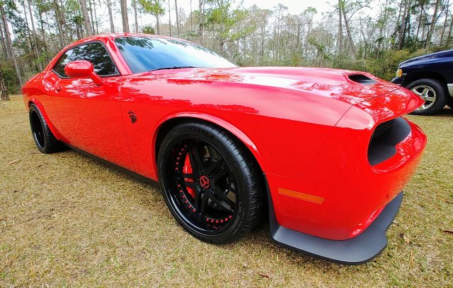

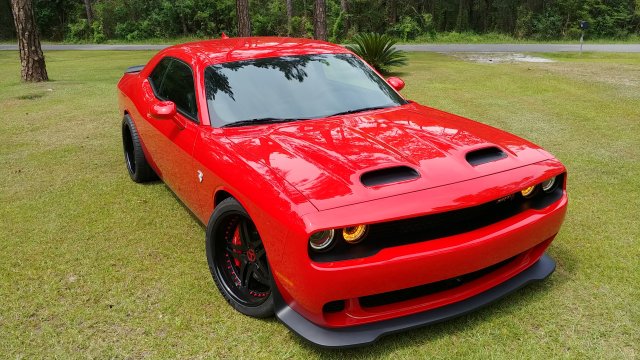

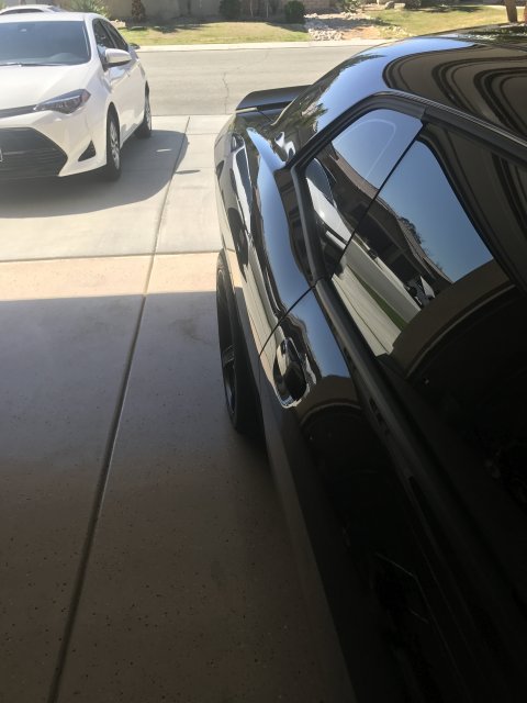

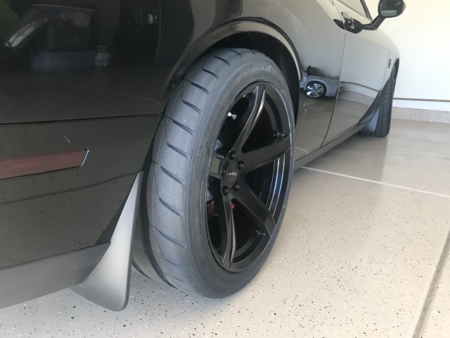

11.5 with correct offset so no inner wheelwell mods required.
(Without flares/with flares)
20×11.5 335/30 (Rear)
Nitto's might be the only exception since they tend to run a little narrow but not everyone wants to run a drag radial daily though. For non-drag radial street tires, a 315 isn't going fit on a Challenger without poking or rubbing.
