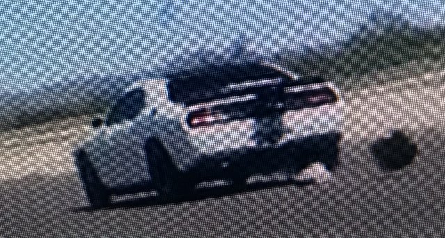

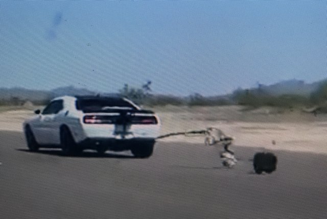

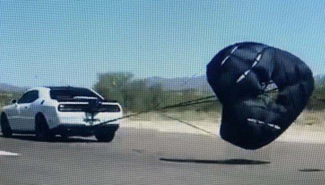

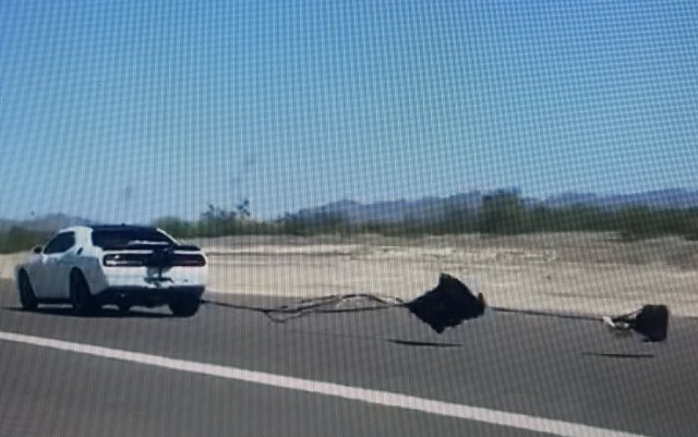

Ok. I guess itโ€™s time to do this again ๐Ÿ˜‘. I ran the standing half mile a few years ago. I ran 183+ mph. I had the stock 2016 spoiler. I also had a chute. It was angled up at 45* (like they are supposed to be). When launched, the pilot chute goes up into the airstream and pulls the main chute, that is packed in a deployment bag, out behind the car until it opens. The turbulence coming off that spoiler drove that pilot chute and the bag with the main chute straight into the ground, where it bounced along until it was all the way out. That took its toll on the whole thing. Pics tell the story. The roiling wake turbulence behind the car creates drag. That makes the car unstable and slows it down. Thatโ€™s why the DragPak cars (as has been mentioned) take them off. Thereโ€™s only one thing that will cause a launched chute to hit the ground 2โ€™ behind the bumper at 180 mph. And it ainโ€™t good. A18593D0-9488-4227-AE2F-3A5441FD7CBE.jpeg 8A08264F-32CA-4919-884F-205B265FBC53.jpeg 460362A0-C8AC-4CFB-8B36-39E7493A6E14.jpeg 46E296F2-3E91-4507-88FE-E75703082B01.jpeg 2E620275-FBC4-4F91-82FE-29EDEA99C10C.jpeg

Thatโ€™s right. The question isโ€ฆ. In a 4500 lb car, why do you need downforce. Drag cars try to reduce turbulence with long flat extensions and side plates (drag wings) to reduced drag and increase stability, not create downforce. The car will go faster because of that (or they wouldnโ€™t run them). The clean chute launch is just another benefit.

Without the controlled data from a wind tunnel itโ€™s just guessing. Thatโ€™s why earlier in this thread, I mentioned that the factory DragPak from Schumacher Racing had removed that spoiler and was running with nothing. Teams at the level do have access to wind tunnels and I donโ€™t have any doubt removing that spoiler was a result of that. I saw what I saw in that video with my chute and didnโ€™t like it. I also notice that when the chute opens now with the drag wing on my car, it is stable. With the stock spoiler it wagged the rear around to the point that it was unsettling.

I've noticed it will wag the rear a few times as well on deployment. had no idea it was from the spoiler though. I may remove mine just to test that out.
