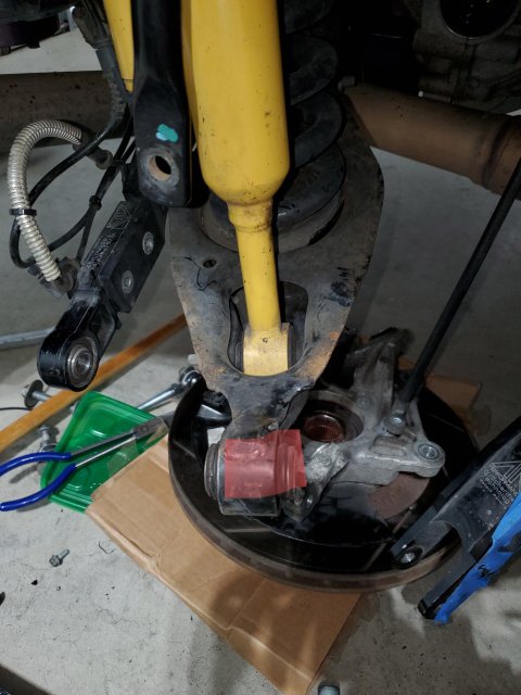

I fought with mine and realized the hardest part was trying to align it even after it was ground down (beating it back with bfh did NOT work on my 15 model)
Only thing that made it tons easier was having a second person get in and hold the hub at the right angle and orientation before sliding it right back in....second side went in with zero issues.
Point or interest is make certain you do not forget the lower bolts for the bottom arm have to be removed and the arm swung out of the way for the caliper bolts to be torqued down......learned that the hard way after I thought one side was complete.

@Wizza thanks for the helpful tips, both ends of the axles all greased up and slid in without issue. it's just that damn knuckle is a bitch to get on. I'll try again next weekend. Next is the AAD rear suspension goodies. Going to drop the cradle for that. Looks like exhaust will have to come down first to get the cradle down enough. Car is laid up until spring, so I've got plenty of time. Your Charger looks great btw.

Thanks much. My buddy crawled underneath the cradle and held the axle in place while it was slid onto the hub, and since he supported the majority of the weight doe a moment, I was able touch more easily orient the hub into place on the lower a arm
I did use a grinder on both sides. Tried the drift multiple times and bfh to no benefit.

This is where I had the challenge until my buddy showed up to help.
Also don't forget about the order of reassembly and torque so you don't have to partially disassemble it again to get that trail arm torqued AFTER the caliper bolts.

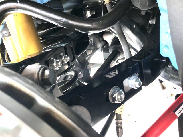

Hoping to get my cousin over on saturday to give me a hand. Much easier with two people. I’ve still got to drop the cradle to do the AAD arms install. I guess I may as well drop the exhaust as I don’t think I can get the cradle low enough with it in place.

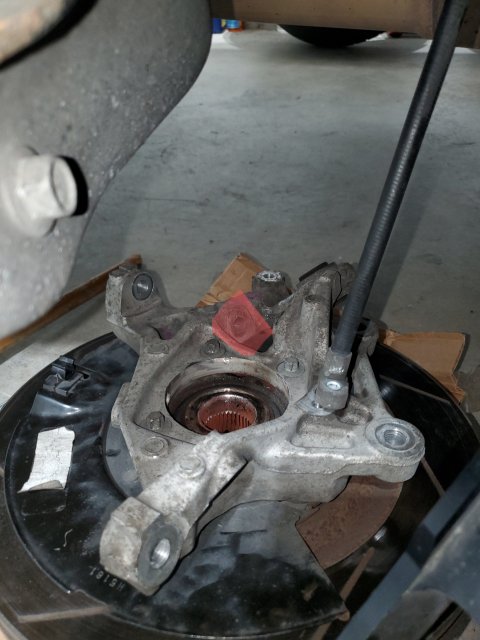

Have you considered using a piece of threaded rod with a couple of nuts and washers to spread that bushing out for clearance ? Pappy always taught me to work smarter not harder
Actually I think that helped me to install the drivers side. Didn't work this time as I stripped the nut doing the pulling. Had to cut it off with a wheel. That sucked. I even tried putting a little heat to it. Still nfg.

done! Finally. Demon Axles in and a few AAD pieces. I guess the next purchase should be the rear toe arm links or the tension arms? Due to expenses I need to spread out the cost.
