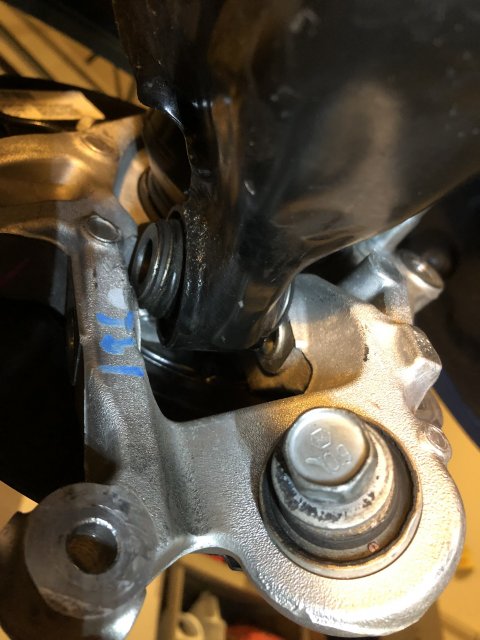

So I’m installing the Redeye Demon axles and I’m stuck…
2,534
6,980
on the assembly end of trying to get the lower control arm (I know that’s probably not what its called) to the knuckle. For the guys who have done this, any secrets? I knew reassembly would be a bitch as I had to beat the piss out of it for removal, which made me nervous with those cast aluminum pieces. So I’m thinking of putting an abrasive wheel to the 4 mating surfaces just to gain a little room. Maybe grease ‘em up then try to install. Thoughts? Thanks as always.

I don't like the idea of removing material from those surfaces. (At most, I might consider putting a small chamfer on the leading edge to facilitate the initial engagement). You don't want to lose the tight fit tolerance between those two parts once they're together.

Is the sliding pin knuckle causing the issue ?
Seems to be @Hpindy . Since it's located in that rubber bushing it moves all about while trying to work one end in, the opposite side is moving in the opposite direction. I've got to see of that protruding collar you see on the right hand side will slide outboard, that would help. The mating surface for the left side is right behind that faint white circle. The knuckle needs to be raised up about an inch.
The d/s axle popped right in, which I thought would be the pita part of the job. I also did the front brakes in my CTD, which is my daily driver, so it was a relaxing day off of work, working on cars. I had had enough by the time I got to this point. I'll hit it again tomorrow.

I just looked at an old video of Speedys, he says that sleeve can be tapped back to aid in getting it back together. He also hit the surfaces with a mild wheel. Looks like I might be good to go for tomorrow. More later. Thanks

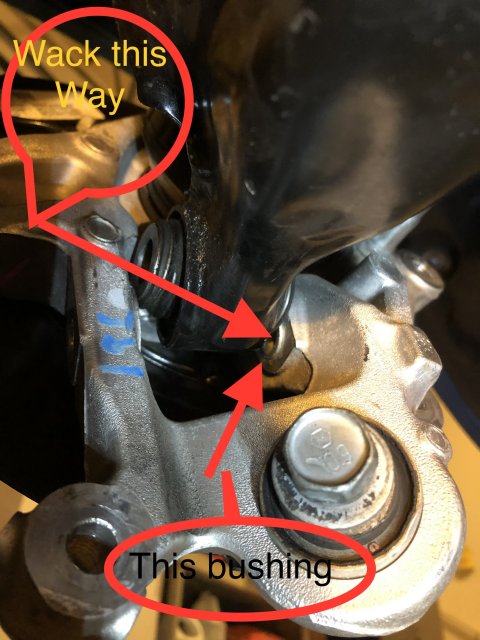

Don’t grind anything!! Take a brass drift and with a big hammer wack the bushing back a few thousands and it will slide right up in place. It’s the worst part of the job doing it via the wheel hub side. If you do it this way enough times you’ll get to know to wack the bushing back before getting the new axles in place. When you put the Allen hex bolt back in and torque it it pulls it back in place again, so every time you take it apart you have to wack it back a bit before it will go together again. I’ve done it both ways, dropping the Diff and doing from the hubs, each way has its pros and cons.

^^^ Exactly. And if you can’t get to it because there is crap in the way, you may have to take a few things back apart, but that’s the only way you’re getting it in there. Don’t touch any of the surfaces, no need. Whack it and be done.

So the drivers side complete. Getting that knuckle assembly together was a serious pain in the joint. I guess I managed to get that bushing in enough to get it all together, not an easy task however. Dreading the passenger side, but maybe over the weekend? Also, my AAD stuff arrived today but I’m concentrating on getting the axles in. Next task will be the passenger side axle and the suspension bits.
