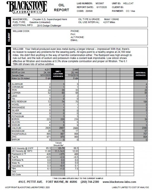

Just got my latest oil analysis report. Just under a year in the crankcase and using, dare I say it? A non MS12633 oil. Mobil 1 for the win in my book.

Any chance you sent in the factory oil at your first oil change? What did they say? No break in adders correct?

I really wish I had, basically I drove it home and changed it as soon as I could. I didn't like fact it had been in there for a year and halfish and only driven 700 miles. :mad: But it was low, even with the drain from the oil cooler it was just shy of 5 qts.

I ran across a UOA on factory fill (think 2016 Hellcat) and didn't have any indication of break in adders... but may not be finding if different from moly or boron, etc. Who knows?

Just wondering. Stock air filter, or after market CAI?

I just installed a JLT CAI at the time I did that last oil change. So I've been running the stock air box until then.
