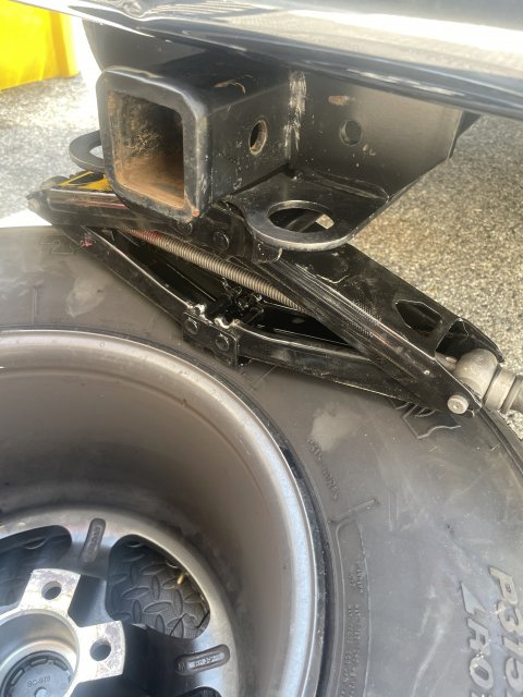

Unmount is even easier
IMG_7669.jpeg IMG_7670.jpeg IMG_7671.jpeg IMG_7672.jpeg IMG_7673.jpeg IMG_7674.jpeg IMG_7675.jpeg
8,887
7,804
You didn’t do it all the way I’m not convinced lol. Also I didn’t have anything to rest other side of wheel on I did it on the floor. It was free aluminum I had laying around. Telling ya the 17’s are crap to do
