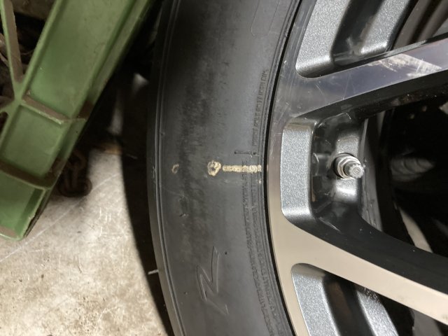

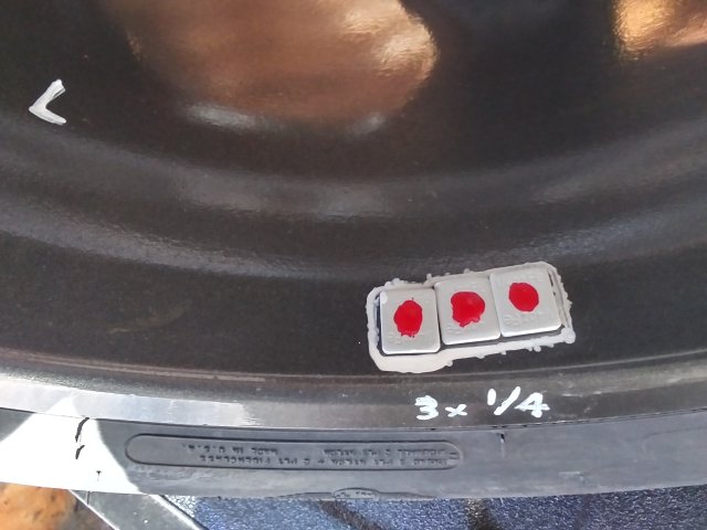

I gave the wheels to the shop and had them balance the wheels only, no tires. I marked the placement of the wheel weights and photoed them. Then I gave the shop my wheel weights which were a different color to use to balance after the tires were mounted. Marked and photoed them.
The purpose of this was if the tire slipped, I could shift the “tire” weights without affecting “wheel” balance.
