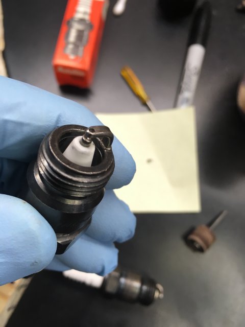

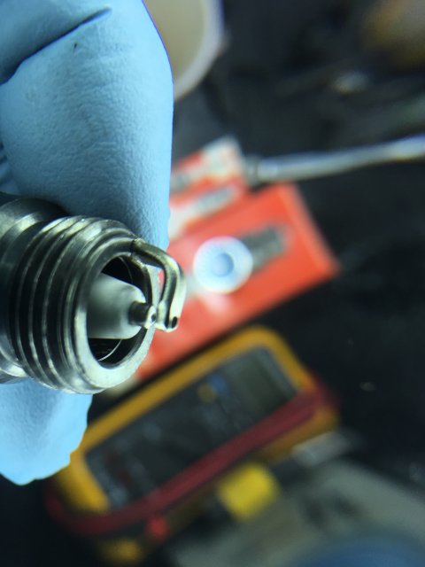

You are 100% correct here, you want to run the biggest SAFE gap possible. Also the projected tip of the NGK2309 is NOT the optimal design to use at higher boost and/or spray use, a shrouded “non power tip” is recommended to reduce the chance of detonation from a glowing ground strap. I’ve yet to try such in the cat but I do use such in my Capri that I spray. I even mod 11E01768-FD4B-4D52-B530-08FE41DCC706.jpeg 8C83179A-7D22-463A-80A9-11ED6D588ED8.jpeg 9A22802E-57F0-4356-96E1-D61EF4F494CB.jpeg the plugs by drilling the ground strap to give the spark a shrouded area to light off in. And also index the plugs so the ground strap open end is pointing towards the intake valve so cool intake blast can swirl in and around the electrode to cool it off on every intake stroke. Also take note to how the ground strap tip is rounded to remove sharp edges that can get hot and glow.

You are 100% correct here, you want to run the biggest SAFE gap possible. Also the projected tip of the NGK2309 is NOT the optimal design to use at higher boost and/or spray use, a shrouded “non power tip” is recommended to reduce the chance of detonation from a glowing ground strap. I’ve yet to try such in the cat but I do use such in my Capri that I spray. I even mod View attachment 70486 View attachment 70487 View attachment 70488 the plugs by drilling the ground strap to give the spark a shrouded area to light off in. And also index the plugs so the ground strap open end is pointing towards the intake valve so cool intake blast can swirl in and around the electrode to cool it off on every intake stroke. Also take note to how the ground strap tip is rounded to remove sharp edges that can get hot and glow.

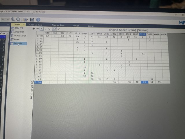

I was getting knock on one pull but not others. Many variables in play. Decides to log misfires to see what was going on.
however not a single cel for misfires, leads me to believe spark blow out. Running LFR6s from ngk, gapped to .28 I think, have to look at my old posts.

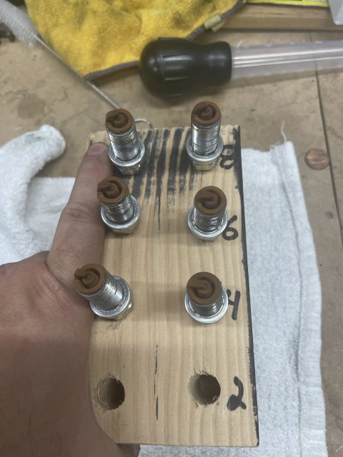

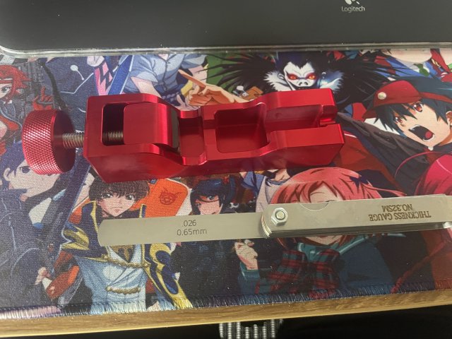

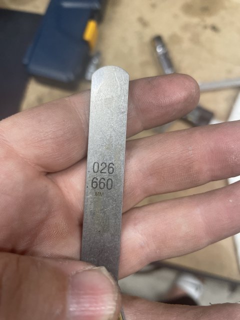

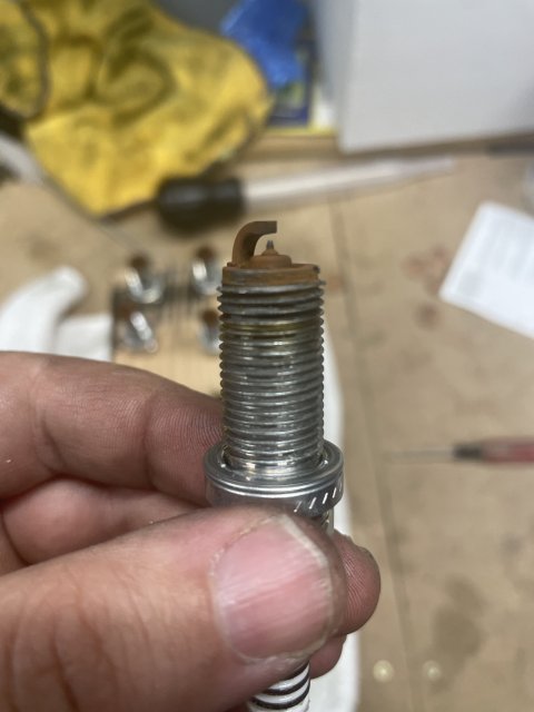

DFD55302-4B64-456F-904C-F7D0E4E53B9C.jpeg 8B279AA9-3F62-4E35-9232-8F7447DE19B3.jpeg 03A4E12C-94D0-4247-8F23-F150481F6BF2.jpeg
Pulled 4/6/8. Couldnt get to 2 due to drag valve. Will have to evac AC for that one. Tomorrows hell, emptying bmr tank and the doing 1/3/5/7. New gap is .026. Picked up this tool for easy mode.
the feeler gauge is shit and checked it with calipers. My oem tools one is super accurate
4,062
10,148
Thread Starter #155
And before it goes all conspiracy theory. I ran 260GT plus on these plugs, it contains MMT. That's why the plugs are orange.
Very interested in out come to see if misfires abate and your knock this run but not another run goes away from this change. Are you changing anything else or just plugs and going a hair tighter on gap? Did you check the gap of removed plugs? Your installing new plugs right? NGK2309 or??
:unsure: umm, it looks a lot like the dreaded Boostane. :LOL::ROFLMAO:

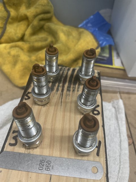

View attachment 70624 View attachment 70625 View attachment 70626
I have 1 of those spark plug gappers, it does make it easier to do once you get the hang of it.
