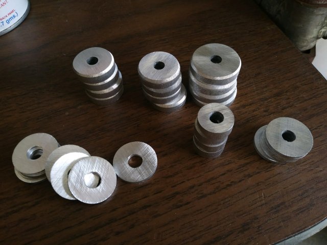

Home made spacers/washers for the seat install. 0327201723a.jpg

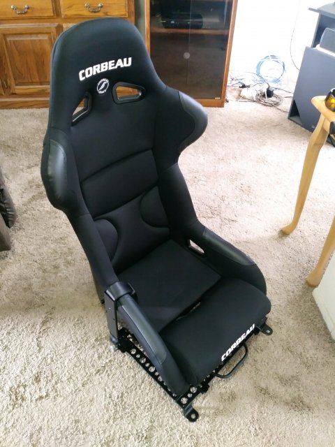

My actual seat installed on the seat bracket ready to go. I like the dual locking sliders. It all feels solid like OEM. The spacers are in case I need to raise the seat up. I know @Marc W had to raise his Braum seat and I wanted to be ready for that if necessary. It feels low sitting in the living room........

That's a nice seat.
But I LOL'd @ "It feels low sitting in the living room........ " :p
. View attachment 15445
Ok. Be honest. You made racing noises when you were sitting on the living room floor.... 😁
... all while holding that imaginary steering wheel and mashing those imaginary pedals!!
Vrooooommmmm!!! ;)(y)

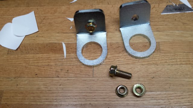

These look like they will be fine.
But I would not drill out the center of the
fastener.
I used grade 8, 7/16 flange bolts and serrated flange nuts, as the only locking mechanism.
When I TIGHTEN the tie down straps
I try not to stand in front in case it let's go.
DRAGRCR
#1181
1,562
5,142
VICTORVILLE
MANGO D170
I have done a lot of research on LW bolts. Some are actually made out of CM tubing with the head welded on. I am pretty sure through drilling a bolt or gun drilling it does not weaken it much if at all. Think Gun Drilled axle. If they were weak they absolutely would not do it. I used serrated flange nuts on the Demon when I put them on and that worked out perfectly, because they stayed put when tightening since you do not have access to hold them. But those were 3/8". I was worried about the flange on the 7/16 nut I am now using not sitting flat inside the frame and causing the fastner to bind when tightening and break the fastener or come loose. So I went with normal grade 8 nuts. I decided this from memory since I do not actually have a car here. Maybe it would not be an issue.
hell on wheels
#1330
502
774
82
Saint Paul
Dodge SRT Demon
If you have to stop suddenly at 65mph with your tow truck. Or get into an accident.
My guess is they may stretch then shear.
The hollowed hex heads will pop off like a dandelion.
I don't see the benefit of losing that little bit
Of weight.
hell on wheels
#1330
502
774
82
Saint Paul
Dodge SRT Demon
Because the nut has to spin down freely
Inside the cross member.
These fasteners should be checked
periodically for tightness.

I ran gun drilled bolts throughout my Modified for years. Had some pretty tough wrecks along the way. Never had one of those bolts fail. I remember a chunk of engine block ripped out during a bad accident. Gun drilled bolts holding the motor mount on were used on the next car lol
