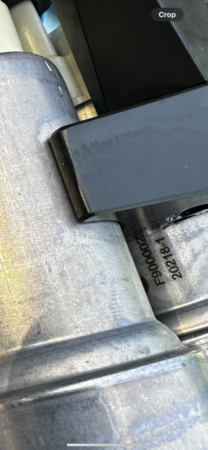

Not sure which pumps they are, can’t see. Whichever ones I jected engineering had in their Gasahol kit 5 or 6 years ago

Number you need to see is under the black holder starts with a two you can’t see the next two digits. If they are five or six years old and the filters were black like that, they need replacing they’re probably not flowing nowhere near what they should be.

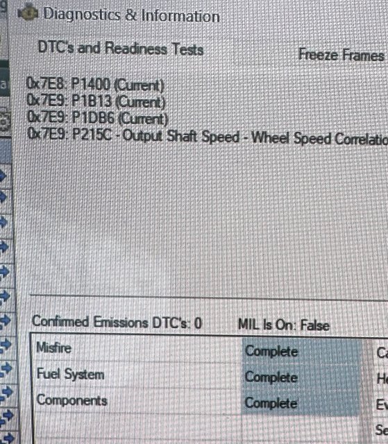

And just some vehicle speed etc related codes from it dying in the middle of driving
