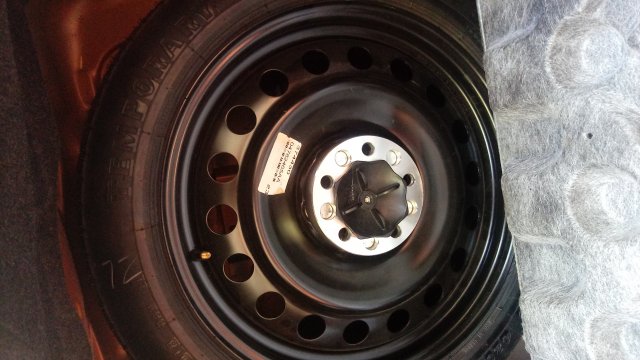

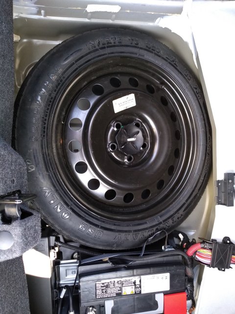

Can I please get an idea on how wide this tire / rim combo is at its widest? I’m looking for a spare that will both accommodate the HC’s large brakes as well as fit beneath the rear strut tower brace I just installed. Looks like Ive got about 8 inches:
Can you still access your tire well under the trunk carpeting? I took out that big piece of styrofoam and was able to mount it all there. The jack and all mount under the tire. There is a wingnut under the tire that holds the jack and handle down so it doesn't rattle around. Then there is that big flower looking hold down on top of the wheel that holds the wheel down (this is the stuff mounted in my car. I have also included some size comparison pics compared to my factory tire.

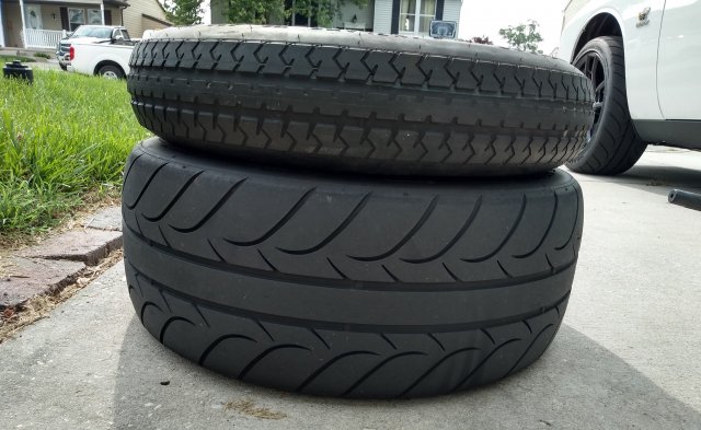

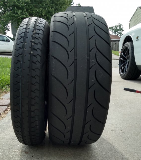

FYI - I was re-installing my drag wheel/tire setup on my REWB today. I had seen this thread earlier and decided to see if my 28" M/T front skinny would fit into my spare tire well. It comes close but just won't go. It might go if deflated.
Just info for the sake of info...

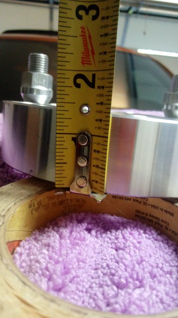

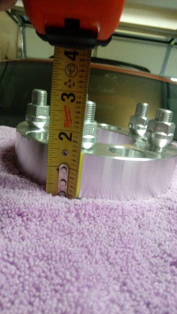

Ok...I found the info and pics from the other forum regarding the spare tire debacle.
This is what he told me about the spacer, and these are the pics he sent me. He has a 2011 SRT 392, and his car came from the factory with a spare and spacer to fit over the front 4 piston Brembos.
Many thanks to Roostking....not sure if he's on this forum or not.
"3 inches to the tip of the lug, Spacer itself is 1 3/8 inches thick "
This place sells similar spacers you just have to pick the correct thickness.
https://adaptitusa.com/dodgechallengermagnumchargersrtsparewheelspacer.aspx
