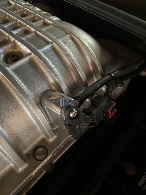

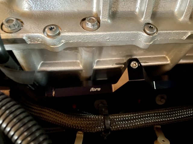

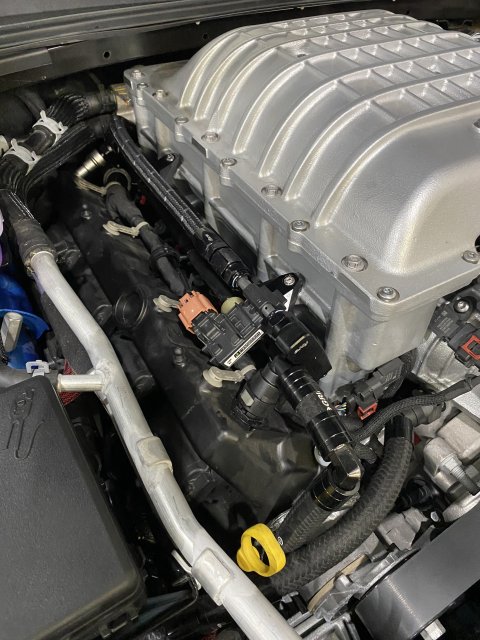

I got my car back today from HHP today. I decided to go with a 2.85 litens and an e85 conversion.

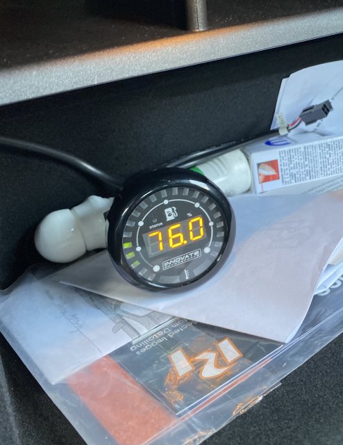

I also wanted an Innovate ethanol content gauge which required Fore fuel rails. This e85 conversion also required dual boosts pumps and ID 1340 injectors.
Needless to say I’m ecstatic with the results.

Looks like a nice setup. Odd item behind that ethanol gauge pic though mate LOL.
Surprised you needed dual boost a pumps with the RE fuel system.
Lol that’s a marker to write numbers on the windows at the track. I was wondering how long it would be before someone commented on it.
The boost a pumps are more for insurance.

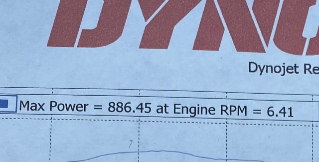

It’s a pump e85 tune. Josh said it’s good for e75 and up. The pump e85 I gave them was around e76. I wasn’t interested in a “Flex tune”. I do have a 93 tune I can use for emergencies, to clean it out or for storage. You don’t want to make that boost with the 93 tune.
4,255
10,587
Nice! Looks like fun. Looks like the 2.85 on a redeye with e85 is good for about 40hp over a standard hellcat.

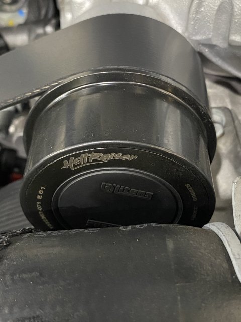

The RE 2.7L blower being bigger than the Hellcat 2.4L accounts for that extra power on same pulley size. Those in the know have said a 2.85 is the max pulley that should be run on a 2.7L blower though due to rotor deflection.

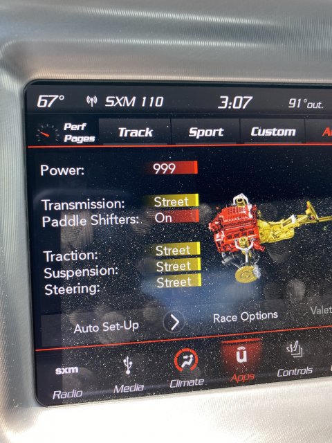

Interesting note on the 2.85 pulley max on the 2.7L blower. I recently switched from a litens 2.85 pulley to a Griptech fixed pulley, switch was made due to the Liten pulley failure. At the track on decel after the 1/4, the blower rap noise on decel is extreme as the car decels thru the gears slowing down from 140mph. I'm considering switching into neutral at the end of the 1/4, the shock load on the blower as the car decels thru engine braking in trans mode sport or especially in trans mode track has got to be tough on the blower. At least it sounds tough on the blower. For the track, it should also be possible to tune out the decel engine braking/downshifting strategy that these mode settings employ..

That decel off throttle stuff is why I went with the Litens pulley personally. I've heard some of them have had problems, but I've not had any with mine in a few years now.
You could technically change the down shift points in the tune, but would be a bit complex on the front end to get that right based on output shaft speed.

@Speedy! and @nate-roth . I had problems with a Litens 3.17 awhile back that I posted on here with pics. Was getting real rattley, marble noises coming from the blower snout. Turns out that was an early prototype that wasn't supposed to be sold to the public. Just recently installed a brand new one (another 3.17) and all is quiet so I was like "Yea problem fixed!". Now I'm hearing about possible failures??! Have not heard of that. Oh well, another 'aftermarket' potential problem to worry about.
Funny thing of note: When I was installing, it said in instructions to only place pulley face up on surfaces while waiting to install or damage could incur. I thought that was weird and seemed kinda delicate of a piece to be taking that much abuse on the frontline of the boost situation. Like, what are the internal guts gonna fall out of position if placed wrong on a completely assembled ready to be installed piece. Just seemed weird to me.
There have been some reports of the decoupler system failing in a few of the Litens pulleys. I don't think it's wide spread. I have one of the very early 2.72 Hellraiser pulleys that I've had on my car for like 3 years I think. LOTS of WOT pulls and track runs with it and no problems (knock on wood). After I installed mine one of the Litens engineers reached out asking how my install went, asked for a couple measurements, and informed me that not all of the cast blower snouts were exactly the same length and in some cases the pulley could contact the snout and have issues. Temperatures, thermal expansion of materials, etc all impacted that occurrence and I think now a small washer is included to make absolutely sure that doesn't happen. Mine doesn't have a washer though.
