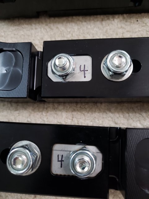

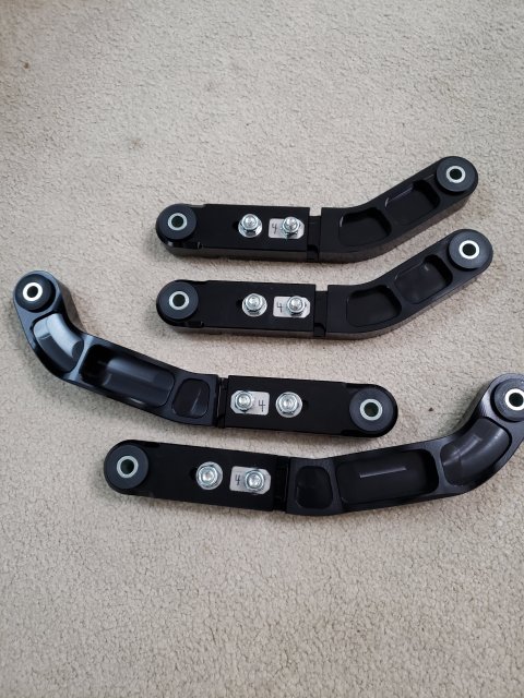

Going to do my arms this weekend or next. I decided to start off with the 4 tabs 20220518_173526.jpg 20220518_173529.jpg

What was interesting in the instructions is it said you can make all your camber adjustments with the long bar (one next to spring). I would think they both need to be the same but that isn't how it reads. I just started with them both the same

I did the trailing arms on both of my cars and it really made a difference.
I did the trailing arms back in 2020. I have the 4 uppers arms now. I probably won't do the toe arms being the factory are adjustable
I did them too just to get the mushy rubber bushings out of there. They are beautiful parts btw. Too bad they are under the car.
My setup went together in pieces, just what happened. The toe arms are $400 so not thinking it would be worth it
That call gets interesting. I would start with both the same. If you run into toe adjustment problems you can start playing with the “front” arm, but that is a dark highway. I spent maybe six weekends all together screwing with the alignment and those tabs, since I have the whole set. But changing out just one of the two sometimes returns surprising results, like N/C!!
