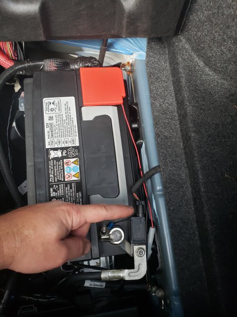

So this is what I found to fix my issue.
jgilj Said about a quick disconnect for the battery sense wire. I found this connector on the negative battery terminal. I disconnected it for 10 min and reconnected it. Like magic the problem was gone. Everything works as it should once again. I attached a picture because I didn't think it could be this simple.

Awesome.
I’m glad that worked for you also! These cars and electron’s 😂
