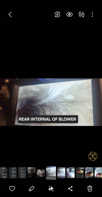

Yes mate I meant with the supercharger lid removed and standing over the engine I place my hand on the right supercharger totor through the top opening and can see that it has a bit of play/moves a touch. Using a borescope camera also shows bad rotor coating sheering nearly 360 degrees around the left supercharger lobe....and the via borescope camera again the rear passage/casing has from what I could only describe long deep gouges/scratches....high velocity material/debris maybe....
I'll take some photos tomorrow of the blowers snout and the "strange rough metallurgy type change/yellowish discoloration" too.

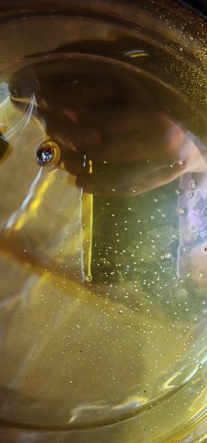

Fyi attached are pics of what came outta drivers side cylinders in bottom of my wetvac....copious amounts of oil in cylinders
sorry if I upload same photos as before.

Hey mate, I replied to your post with heaps of photos just awaiting "moderator approval" for it to come out online....

Here's a couple of pics of what came out in my wetcvac amongst the unburnt fuel/gunk/oil on top of piston heads through spark plug hole....😳
And a photo of one fresh outta cnc machined type looking engine cylinder....NOT smh 😫
