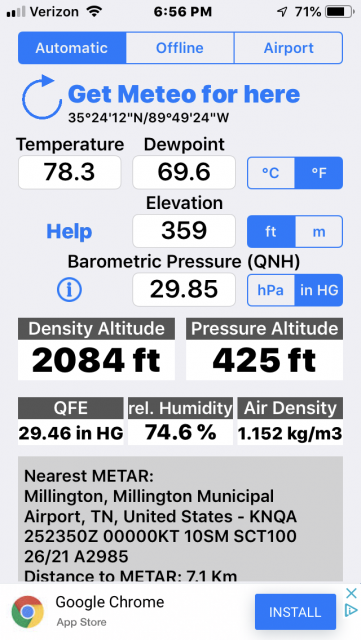

I have a App on my IPhone called Density Alt+. I think it was $1.99 to purchase. My son is a professional helicopter pilot flying search and rescue in the Sierras and he is using it. It shows GPS altitude, Barometric pressure, Altimeter setting and Temp as well as the DA. I check it all the time as I travel and it is right on as far as GPS altitude goes, so it definitely knows where it is. Takes seconds to get a read out. It’s showing DA is 5156’ at my house right now. Alt is 3231 ft and OAT is 80 degrees.
FYI - while researching this App, it appears it uses only a dry air formula to calculate DA. In the course of my ongoing research to build an Excel spreadsheet compatible with an iPad, my research into DA calculations for drag racing repeatedly comes back to the necessity of including the "water content" formulas for a more accurate DA calculation, especially when tuning is/may be involved.
The Kestrel meters use the aviation-oriented formulas, many/most based on the ISA standard (International Standard Atmosphere). This standard, as well as the standards used by the aerospace and automotive industry focus on the air density, while the Motorsports Standard focuses on the oxygen density, to arrive at a DA figure.
My $0.02

I have an auto density app ,it was free to download and I checked it and its accurate with in 5000 DA

The ambient temps that day started off at 88f plus humidity and peaked at 96F plus humidity. The Da started off around 2500 and peaked at 3300. The day was gross. I ran 4 passes on each intake . I tried to keep each pass as equal as possible. ( a big cool down then a hot lap then 2 20 min cool downs) .
