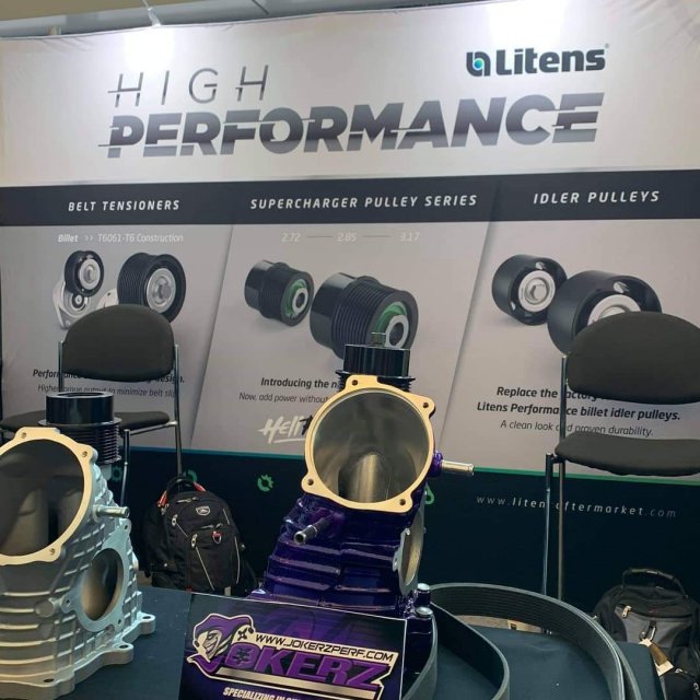

Ooof! That's a big unit. Did you see the high volume blower snouts from IHI? They beefy.
Hey motorhead
What high volume blower snouts are you referring to?
Do you have a link for more info on the snouts?
Jokerz Performance is putting out some dam good quality ported snouts,TB & ported blower’s!
