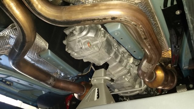

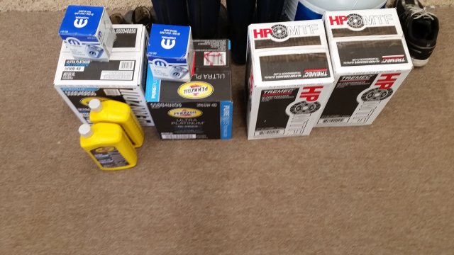

No CDV yank or skip shift bypass for me yet but I do recommend changing out the factory fluid with the TREMEC HP MTF. 20200314_100828.jpg 20200314_110719.jpg

Did changing the fluid quiet down the gearbox? That was the first thing I thought about but I’m pretty sure I’m hearing the throw out bearing. Difficult to believe the throw out bearing would be bad after 4 years and 21k miles though.

Ya just corrected my post while you were typing as I wasn't sure.
The TREMEC fluid is definitely noticeable in "feel". More buttery shifts I guess you could say. Didn't notice any noise delta but mine was very quiet before.

Yeah it’s definitely the throw out bearing I’m hearing. I may just be hyper sensitive to it though and I only hear it at slow speeds when engaging/disengaging in the 1-2 shift.
It doesn’t sound bad, I can just hear it, maybe I’ll just make a piece of insulate to mount below the shifter boot when I install the Barton.

Yeah I’m going to get the car up in the air and take a look at everything (just to make sure there are no surprises) and then I’ll likely take it to the dealer and let them take a look. It still has some powertrain warranty on it, I’d assume that’d be covered.
It makes the most noise when I’m at a stop with the car in neutral and my foot off the clutch pedal. The minute I engage the clutch, the sound goes away, that’s why I’m assuming it’s a throw out bearing.
