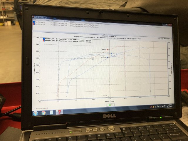

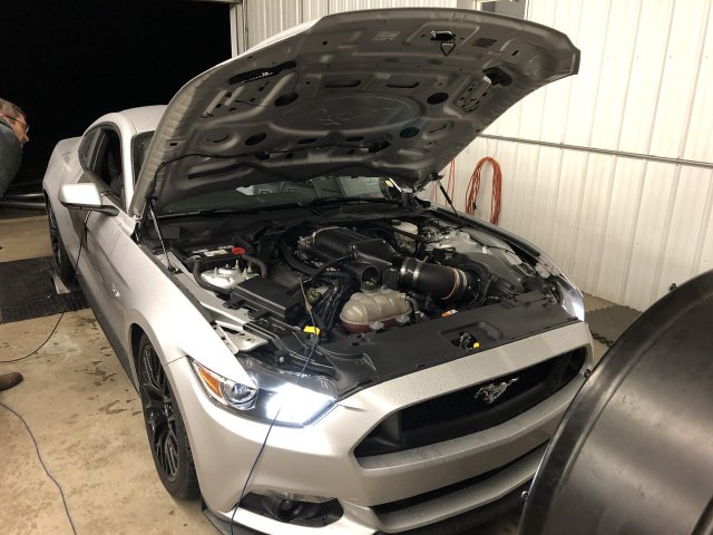

My buddies 17 mustang with HP tuners he can limit throttle % by individual gear and some how it knows what gear cars in (M6) with nothing (that can be seen at least) telling the pcm what gear it’s in.
3,796
8,991
#76
He suffers same issues we do, he’s making 800 wheel to, we all just dyno’d last night at a garage party. Limiting power by gear has made controlling wheel spin on launch manageable and much more repeatable.

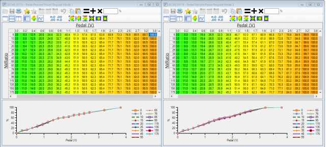

So much easier to tune the throttle.
https://forum.hptuners.com/showthread.php?78871-NVRatio-information
This is from the stock Demon tune, you can see the Street tune on the left and the Track tune on the right. The obvious difference where the pedal voltage equals full throttle sooner (basically anything over 2 volts), you'd need to log a few parameters to see how the car is responding to your demands/driving style.
