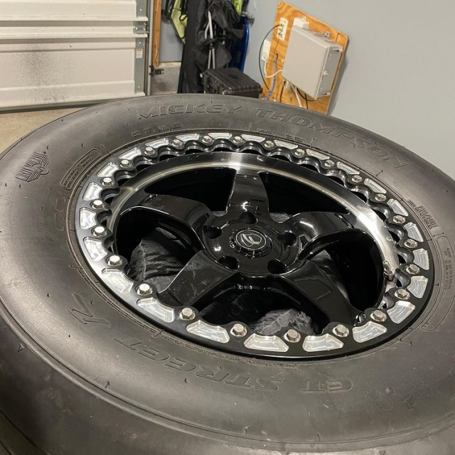

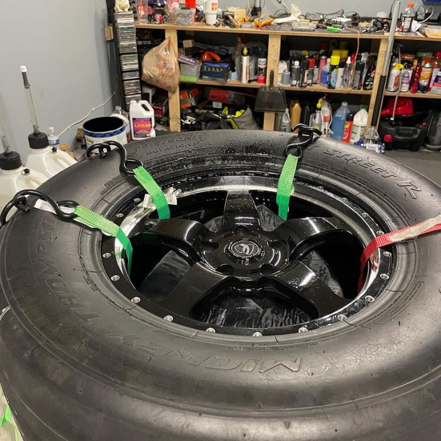

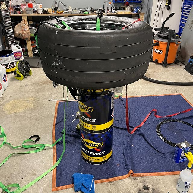

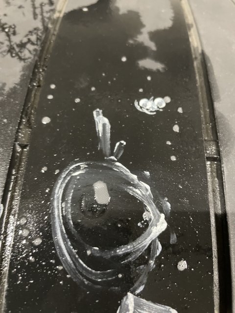

Well I'm in a pickle. Looks like the patch isn't going to hold. Introducting the Beadlock 5000, the backsaver 8000000
Sad though, getting micro bubbles.
Going to check it in an hour…

Thread Starter #29

Thread Starter #31

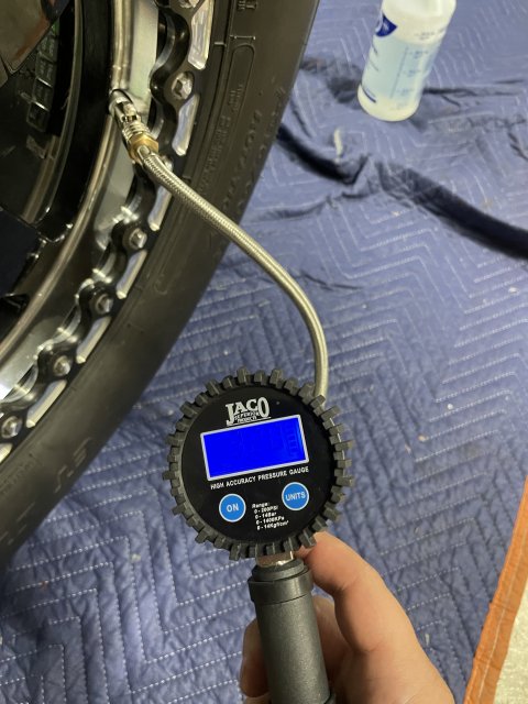

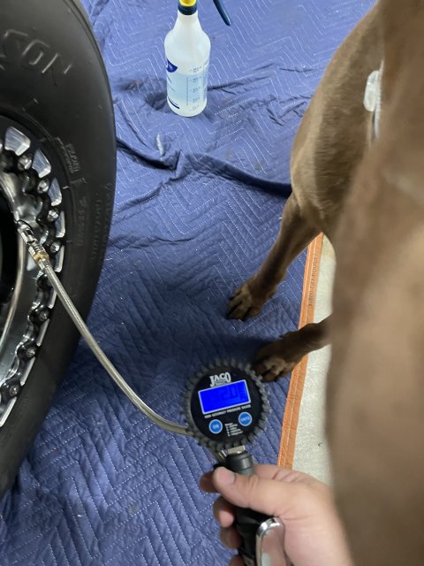

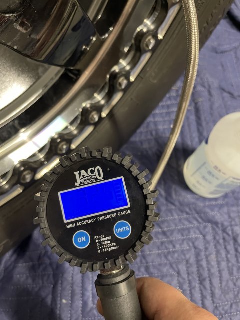

Sorry, quite angry. So the "pickle" is this. I want to be in Streetcar-Takeover this weekend at MIR (Aug 14TH). If the patch does not hold I cannot get another 315 in time. That would mean putting on the 305/45r17 I have which I don't want to as they are brand new. At 1830 the tire was at 32PSI, I will do another check at 1930 and report back. Sorry words, yes I should use them better.

Still at 32psi, done issue. If she goes, she goes.
