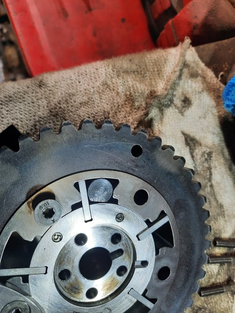

I have the same cam waiting to be used, just installed the vvt block the other day
Ill do that when I get some free time. Otherwise Ill lose it haha.

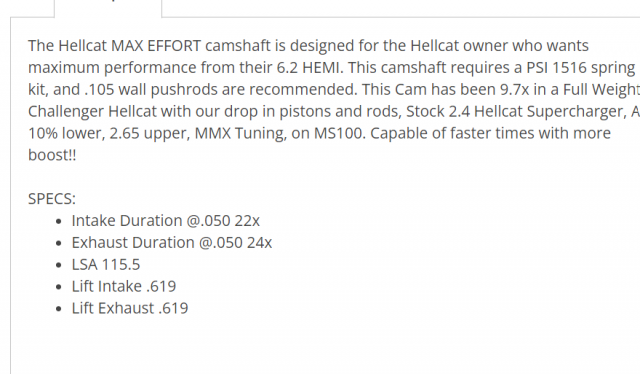

This is a fantastic camshaft for a boosted engine.. -1 overlap so you are not blowing boost out the tail pipe and the opening and closing events are very very good ..

What you guys didn't want this cam that says with a 2.65 upper and a lower you can get a 9.7 1/4 mile :ROFLMAO::ROFLMAO:
I think that would slow you down with those mods.

A lot of people go for sound .. that is a function of overlap and valve timing. . That may work on a N/A engine for better scavenging but on a boosted engine you are getting less cylinder trapping on the intake cycle .. you will still need a good exhaust path to get all the spent exhaust out of the cylinder.
