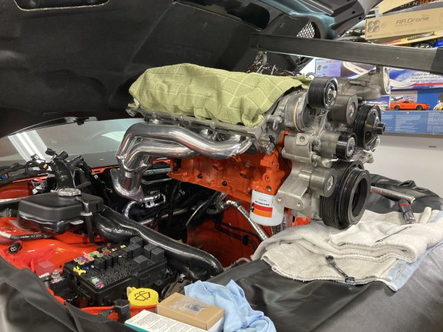

Well being above post was moved to its own Thread Topic but not by me I mine as well finish it. @jonx96 finished my tune and we netted 1077HP but ran out of injector and fuel pump which kept us from going up in timing or boost and breaking the 1100 wheel mark, someday, it definitely has the guys for it!!
I just upgraded to ID1700’s and good air is here so maybe we’ll break over the 1100 wheel hurdle before winter sets in. Stay “Tuned”!!!!

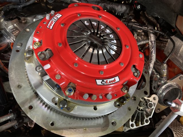

Here’s what we’ll be working with next
