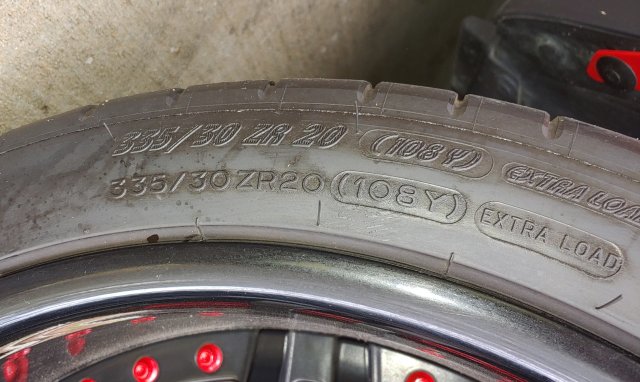

Eibachs with 10.5 aftermarket wheels in rear (which also requires 1/4 spacers), my 16 Challenger HC would rub on roads with dips.
With mopar springs on my 19 Challenger HC, 11.5 triumph wheels (20×30×335 tires) I have no issues.
I do have eibachs ready to install, but as I am using the 30×335 tire and not the 35×315, my hope is that there will be no rub.
