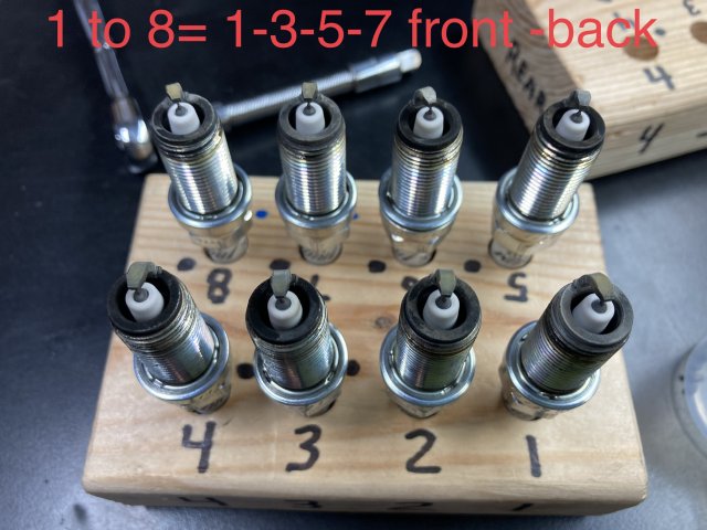

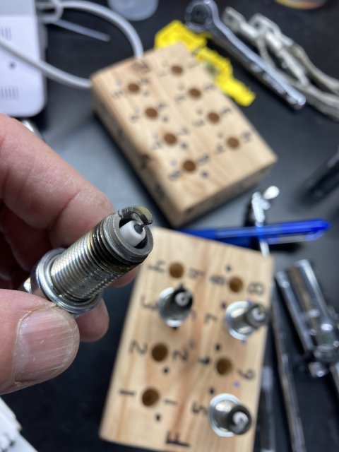

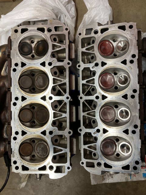

My advice, use it in emergencies only. I was a constant user and swore by VP Octanium Unleaded. It no doubt works, I have many dat logs to prove it, but it hammers spark plugs, exhaust valves, and O2 sensors, even though it says it’s safe on them. Here’s what my plugs and heads looked like after about 7000 miles of the stuff, 1 Qt in 15 gallons. Pistons clean, other important stuff not so clean, exhaust valves being the most concerning as plugs and O2 sensors are easy and cheap to replace, exhaust valves not so. Dirty head on left, cleaned up one on right.
33813C2F-7F99-4DE4-87E1-2576CB3FB168.jpeg BCE7581B-1EDB-459A-8944-65A54D1F5E66.jpeg D89297FE-9CAB-43DC-8045-5879B3B2B210.jpeg

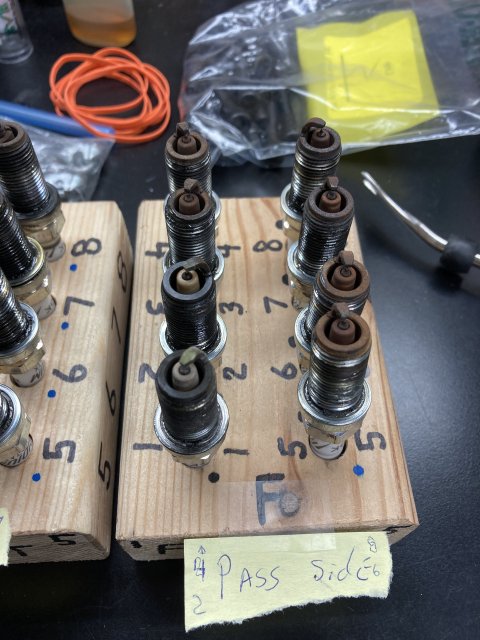

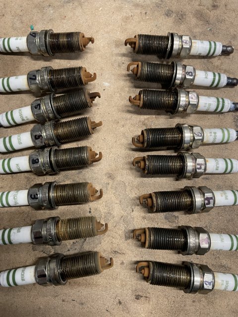

Switch to corn!! This is plugs after 3000 miles on corn!! Put them back in the box and sell them as new lol
9676DBAB-C1AC-4E36-A1C4-87FD2C265356.jpeg 634B952A-3558-4ADE-B649-05EF721E558A.jpeg

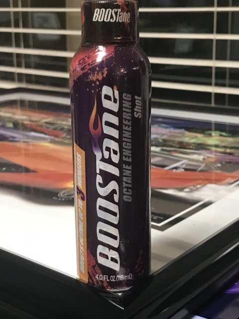

I’ll just drop this here, 4(+) years in my 2015 with no issues and a 93/95 octane tune. One bottle per tank of 91 octane fuel. Also have run it in my untuned 2019 Redeye from day one. Same result. Has been tested and proven by many Challenger, Hellcat, Redeye owners. 6D9EB407-DE9D-4738-A6CA-3FA09E49A87B.jpeg
