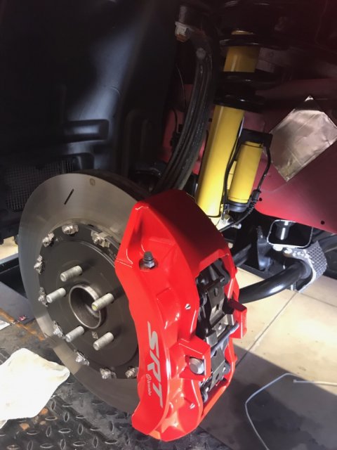

Yup, entire wheelhouse area is near perfect.

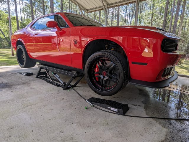

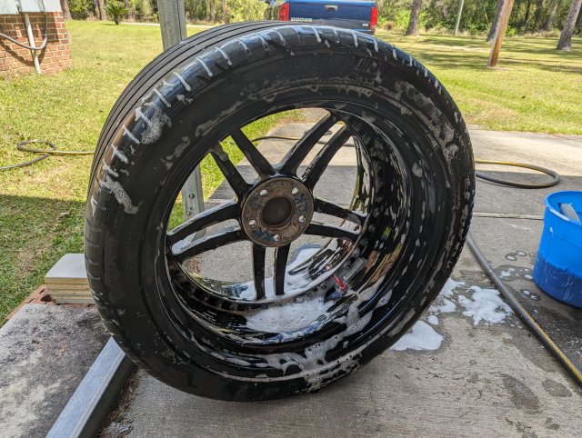

Done recently...
