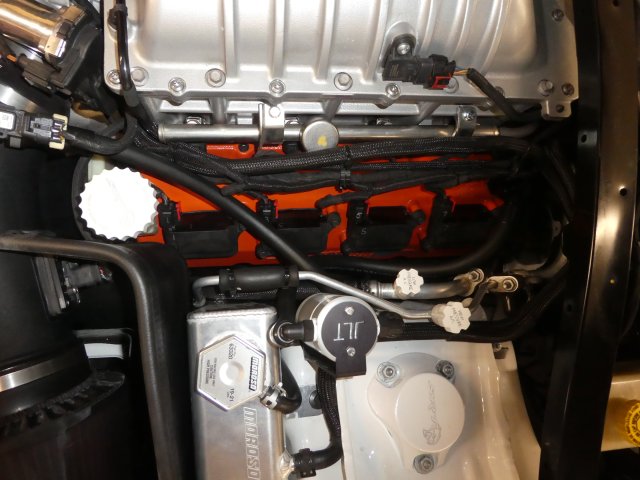

Sucks every single time. I used a bunch of zip ties to secure the super charger lines over last time. Rear passenger is the worst. Actually all passenger coils suck. Gapped em to .021 when I changed them last year so I don't have to worry about them boost wise
8,767
7,692
Get a swivel spark plug socket that has a 2-3" extension built into the swivel part
8,767
7,692
And use a piece of hose to lower them in and get them started a thread or 2. Install dry. Torque to 20 ft lbs (on an angle with the swivel it'll be less, but that's fine)
8,767
7,692
We are talking about a brand new 170 though. Just bring it to the dealer and have them change them. Take before and after pics in case they mess something up

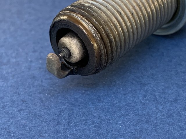

I pulled the #5R plug, seemed the easiest to access. Same type as in Speedy's vid though my gap measured .021". (Speedy mentioned in his vid his tech measured .024".) So it looks like the recall was done and the correct plugs were installed.
Thanks for the help!

Step #1: remove that plastic box on the passenger fender that the harness runs through. Rip it out, throw it away. Wrap the harness in some heat-reflective foil loom instead. Use a christmas-tree zip tie to secure it back to the fender when you're all done.
Step #2: tie the SC coolant lines + reservoir up out of the way--I just use a bungee cord to hold it up.
Step #3: coil packs and plugs--with those two obstacles gone, you can do them without too much trouble.
With the passenger harness freed from that plastic box to be moved around, even though the passenger side coils are still a tight squeeze they become manageable.
On the driver side you have to dodge the AC lines, but they are flexible enough you can still maneuver around.
Just have a variety of extensions, swivels, and use an electric ratchet. Zip zip.

How much, if any, of the Sparkplug changing thread did you use as guidance when you did it?
I haven't done mine yet, but one thing I did do was actively buy a bunch of different tool options that might help me when it eventually comes time. Things like various different extensions with built in swivel heads, sparkplug sockets with integrated u-joints, etc.
I already have many different swivel ratchets, and I'm mentally prepared to take the time to move things like the infamous black plastic wire loom out of the way, and move the S/C res out of the way.
I will also pray to the busted knuckle gods before hand for the requisite 1-week, along with a virginal sacrifice into the top of a volcano... (Meg Ryan in Joe versus the volcano anyone???)
(I'm not sure what virgin I'm going to find, but I hear it helps...)
You don't need a bunch of tools. Getting coils unbolted and plugs out not that hard. Issues are getting coils unplugged and out of the way
