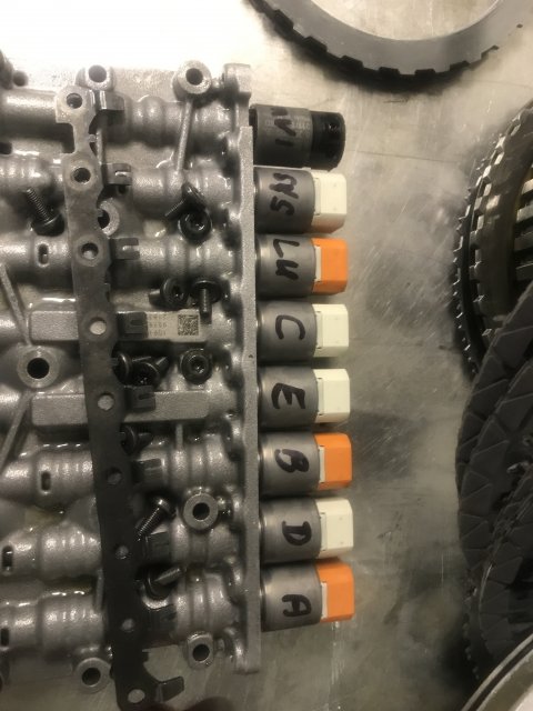

Here’s a pic of the solenoid set up and identity of each solenoid there is a green solenoid on the valve body that is for park function only, I’m shipping the solenoids out today to my friend Noah at Ericsson industries to have the solenoids flow tested , this will be critical as I have found out the solenoids are NOT available separately, you would have to buy the Valvebody from Chrysler at a cost of around 2,000 I will know next week how they tested and of course I have my fingers crossed that they pass with flying colors 7B975174-E70B-4312-AE11-8C0E3DBC4649.jpeg
