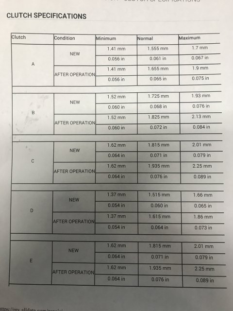

Thread Starter #397
Here’s stock clutch pack clearances
I checked the e clutch in mine right now and it measures 110in as you can see the after run in should be a maximum of 89 makes you wonder how close ZF ACTUALLY CHECKS THEM BECAUSE TGERE ISNT ANY CLUTCH MATERIAL MISSING IN MINE TEY WERE JUST GLAZED OVER 🤔
The stock HP90 A8 trans is pretty stout. I raced my old setup for nearly 3 years, made 50+ passes on a 2.50 upper + lower pulley combo, hundreds more on less aggressive combos, and it continued to perform well.
All is needed is the right amount of caressing and they can usually last a while.
Good to know. I may need this info soon.;)
I thought German engineering was supposed to be superior.:rolleyes: Oh well I guess factory clearances are factory clearances. (FU BMW crowd) .:LOL:
3,361
5,905
Thread Starter #400
Apparently they were lazy the day they built mine but even with that clearance it never logged a fault code or went into limp mode
