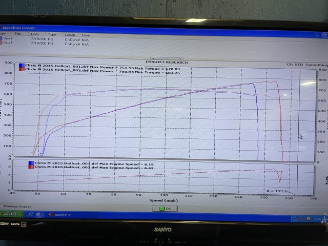

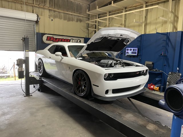

Well, I finally got a chance to put my car on a dyno today and I have to say I'm happy with the results. I have a pretty simple DIY setup on a 2015 m6 hc consisting of incognito lower, double pumps, afe intake and Dusterhoff ms109 tune. DA was 1130 and raining. She put down 751whp at 6350 rpm and 780whp at 6550rpm. 1st pull had the afe pre filter and rain guard, second pull was filter only. I've had this setup for 3 years and got the race gas tune last year. Pretty stoked to say the least👍

Very nice. How much boost were you making?

Like 13.3 but the air was not great. I’ve seen above 14 in negative da

I think it's interesting the few hp and tq gain across the band from taking off the pre-filter and rain cover.
At that power level it takes around 20hp to go a tenth at the track so I always think about that. At my power level it could be 30hp so I have to think if it is worth spending X amount of money for X amount of hp. You are also not going to feel 10 or 20 hp.
I dont have a rain shield or sock on my filter and it does get wet. If you don't want yours to get wet the slight power loss will not be noticed
