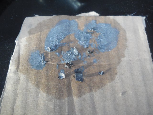

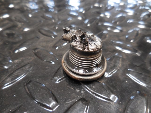

Believe it or not, but it takes a lot less time to check and fill up fluids as needed than to deal with the potential consequences. Plus, I hate noisy gear sets.
Not that setting up new gears is rocket science, but it's not all that fun either. Still kicking myself for not changing the fluid in this one at 500 miles as usual, but letting it go to a bit over 1,200. A few fluid changes and multiple cleansings of the magnetic plug later, it's thankfully still alive, if not as well as it could've been. DSCN0843.JPG
