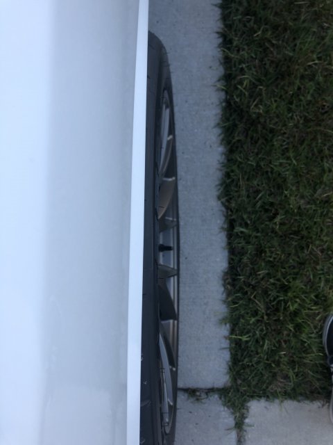

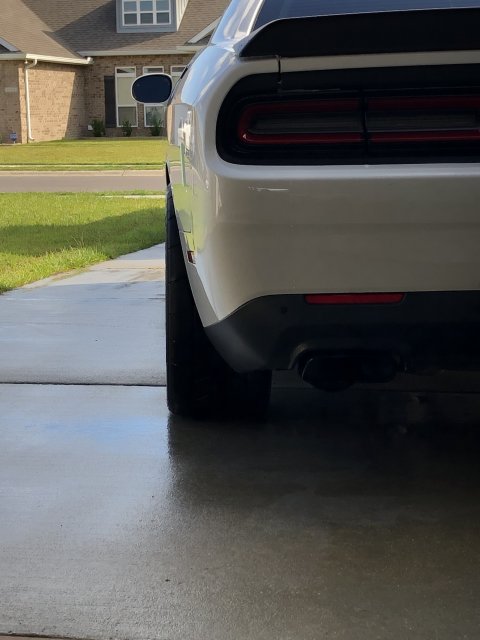

Does anyone know if I’ll rub with mopar springs? 10.5” w/25mm offset on 305’s
8,968
23,646
Shouldn't.
With mopar on now, I have 11.5 w/335 and no rub.
Not sure of the offset though.
When I had the eibachs on, with 25mm offset, and 10.5's, I did need spacers (for inner well rub), and it would bottom out on bumpy roads (like shortcut in pascagoula). But eibachs are lower than mopar.
